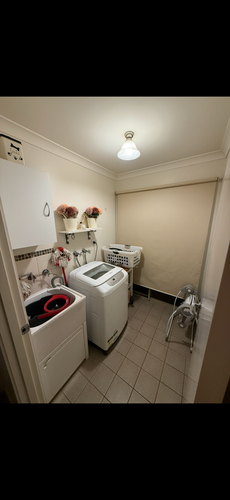

My current laundry setup

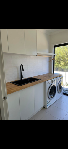

Rough idea of the setup I’m planning

To achieve a look similar to the setup you’ve shown @Tim20, one of the biggest visual differences is that all the services are hidden below the benchtop, including the plumbing and the power outlet. I understand the aim is to keep costs down by retaining existing plumbing locations, but I would strongly recommend budgeting to have the plumbing and power relocated down below the benchtop height. Even if they stay in roughly the same area, dropping them lower will make a huge difference to how clean and modern the finished laundry looks.
With the current setup, the wall outlets will limit what you can do. A recessed sink like the one in your concept won’t work with taps coming straight out of the wall at that height, and having washing machine taps and hoses running down through the benchtop area tends to look unfinished. Moving those services is an upfront cost, but it removes design compromises and is much easier to do now than later.
