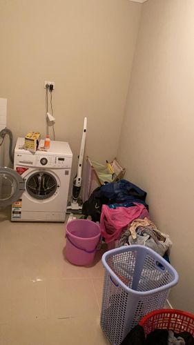

I’m new here and would like an advice on how to install bench and cabinets to our Laundry- we would like the bench and cabinets to run an L shape that joins the sink. We would also like over head cupboards. Any help is much appreciated.

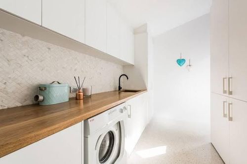

i would like more cupboards with benchtop and an overheated cupboard with one opening. ( as circled)
I will show you an example - the example is how I would like my laundry to be

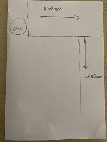

i will provide the wal measurement soo.

I do want to the bench to go al the way.
the measurement is 2.7m
Hello @casey7
I was referring to the other side where your laundry tub is. If you are keeping the tub then you will only need one 600 base cabinet. If you are planning to go ahead with this project just show the In store Kitchen Expert this drawing and they will be able to quote you the entire laundry set.
