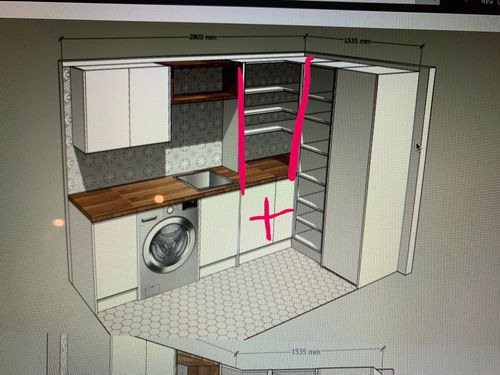

I've made some preliminary sketches of your pantry. You will notice that the 450 pantry does not have a kickboard. This will allow the pantry to fit into the vertical space you've indicated. I've placed the end of your shelves right where the laundry taps are effectively hiding them. I've placed a wall cabinet instead of straight shelves in case you want more storage. However, if you want straight shelves please tell me and I will modify the sketch.
The laundry tub stays in the same place and the plumbing does not have to move. The washing machine is more accessible if placed on the left-hand side of the sink. If you wish to see your pantry in another configuration, please let me know. Have a look at the sketches and tell me what you think.

With the measurement l notice the measurement was actually based on just from the wall over the where the washing machine was in my originally pic. If l went from wall to wall the measurement is actually 3660m for the benchtop so l could probably fit another cabinet underneath
I would love to see open shelving sketch if that would be okay
What base cabinets would they be?
I'm just wondering if both of these wall ends need to be there and whether that end cupboard is able to be used with the cross (+)

Thank you for posting an update on how you want to see your pantry. I've placed an updated sketch of your pantry with the new wall measurements. The Kaboodle cabinets used are listed below.
You have the option of having the shelves painted white using AraucoPly 2100 x 900 x 30mm Clear Pine FJ Laminated Panel. I suggest using dividers along the open shelving to provide structural support and to keep the panels straight. If you wish to see the cabinets in another configuration, please don't hesitate to post and I will be more than happy to reconfigure them.

Yes this is great, l love this design so much better with the open the design
I was wondering if you used the Acacia Solid Hardwood for the shelving and for the benchtop? How many length of this would l need?
