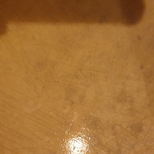

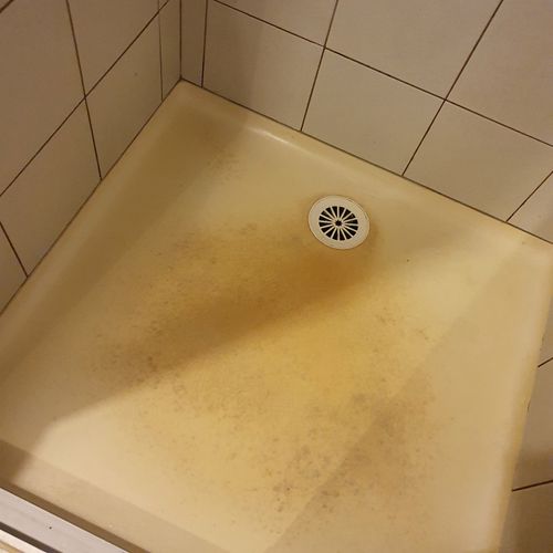

Would like to refresh my shower base but unsure what it's made of. Tried testing with a fridge magnet but was inconclusive. There's terrible staining and scratches/crazing.

I'm sorry to hear the magnet test was inconclusive. I suggest doing the sandpaper test, grab yourself some sandpaper and carefully sand a small corner of the shower tray. Two things will happen, you either sand the surface paint off and reach the steel body of the tray or you end up with white plastic powder. If after a minute of intense sanding and you don't see any steel, odds are it is an acrylic tray.
If it is a steel tray, I recommend White Knight 500ml White Tub And Basin Paint as an option to revamp the finish. However, if it is acrylic, I'm afraid you'll have no choice but to remove it and replace it with a new one.
