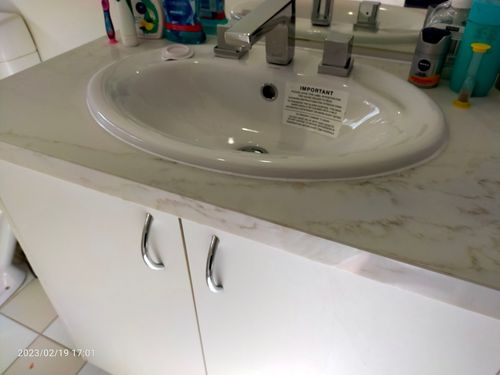

Thanks everyone for the guidance and advises. Attached is the completed task. Feel happy and satisfied.

Re: Bathroom mirrors and basin top
I do it very slowly as I know my original thickness is 35mm whereas my new top is 40mm. So challenging when tapping the mirror. As I used the masking tape mentioned above..it is either the cardboard was too thick as it keep falling down no matter how many tape I uses.. cutting the old top out is also challenging as I wanna do it careful not to break the mirror.. after removing it, I was looking a solution to see how I can put some support underneath the mirror..so I uses the old top cut to the thickness and put under the mirror. Then another challenges is the hot and cold T pipe.. I need to gentle squeeze into it so to make sure it nicely fit onto the hole...lastly always make sure you put container underneath so it won wet anything if the water does comes out

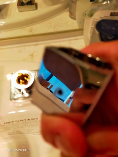

 btw does anyone know what the hole is for in the hot tap and cold tap? Inside I can see a pin but just not sure what it does to it. Also I can feel that when I turn the cold water the top tap scratches on the bottom tap that keep the valve in bay (see photo 1 it resulted a circa lines of scratches). Any solution?

Hello @calccom21
Thank you for that extra information about your vanity top installation. I'm sure our members will find it useful. In regard to your tap ware, the hole on the handle is the access hole for the Allen key. You place the Allen key inside to tighten the grub screw so that the handle will stay in place and not get pulled off.
I also suggest providing a gap between the handle and the base flange. This will prevent the handle from scratching the bottom. I've placed an image below to give you an idea on how it's supposed to be installed. I recommend using a 10C coin as a spacer so that the gap between the hot and cold will be uniform.

Thanks @EricL  - that is awesome photo. I didn't know it. I have done it so it will leave it scratchless. Btw, unrelated to this project, do we know what can we use to cut colorbond roof? (multitool? and if oscillating is same as multi-tool or an angle grinder tool)?

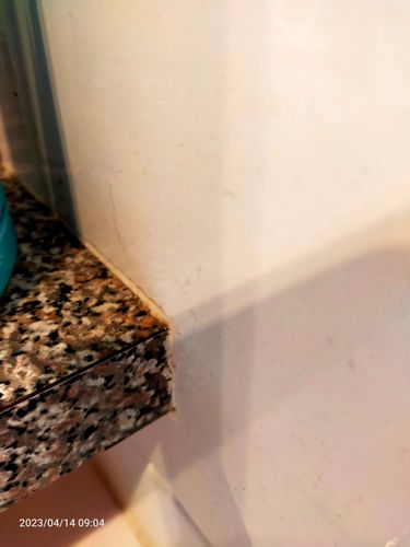

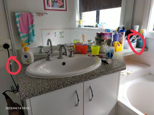

Hi all,
   I'm going to proceed with second bathroom to remove the vanity top.. just wondering if cordless multitool is good to remove the top on the one circle in red.. the glue that stick on the bottom of the mirror to the vanity top? Previous I uses penknife to cut it.. also on the right side it stick to the tiles that is on the wall..can I use multitool without damaging the tile and the wall/mirror?

Hi @calccom21,
I'd suggest that it would be very hard not to cause some collateral damage when using a multitool. This might just be aesthetical damage, but if the blade digs in, it could cause significant damage to a surface. At a minimum, I would expect it to scratch the tiles.
I would always suggest you first start with a snap-off knife. A snap-off knife will effectively cut through any soft silicone that has been used; it'll also do a reasonable job of cutting through harder adhesives. A snap-off knife has a much thinner and sharper blade than a pen knife and will be far easier to fit into the small gaps.
