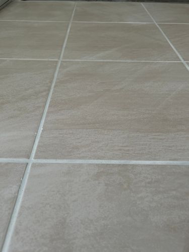

Re: Mouldy grout in shower???
Grouting completed.  Polishing tiles next up and then sealing.  Quite pleased with our efforts.  Thanks again for the advice.
Looks great @BEALE! Well done and many thanks for sharing your results.
