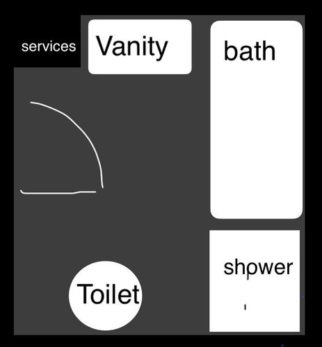

Is there likely to be any issues with putting a 900mm vanity in this space (since it measures 900mm), and having the vanity sitting right up against the bath? Will this be likely to cause issues becasue of the location of the waste, for example, or other issues that may arise from having the vanity touching the bath?
It is a regular bath, not freestanding.
Im not there at this exact moment so I don’t have a photo but this is a not to scale picture of the layout.

My only worry in installing a vanity right next to the bath is accidental splashing of water when the bath is being used. Do a lot of family members use the bath? If yes, then there will be a higher rate of water getting splashed about and hitting the vanity. Now the vanity is technically moisture resistant but if it is constantly drenched in water it will eventually have an effect on its structure. But other than that, I don't see any other major issue with installation. The plumber can re-route the vanity waste so that it is in line with the new basin.

I see no issue with the vanity being next to bath or touching. It's quite a common design especially in older homes when bathrooms even in larger homes were very small. My parent's 1960's home is a classic example of this. The main and only bathroom was 2m x 3m with bath, shower and vanity!

I dont see any issues either, Do your taps/water outlet come from the existing cabinet or off the wall? Thats about the only thing I can think of that would maybe cause an issue if the sink bowl is off center.

thabkyou - they’re not wall taps. They just have the outlet in the wall with hoses connected to a mixer tap in the basin.
