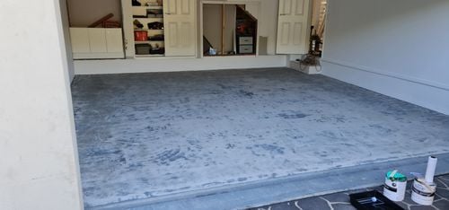

preparing the floor by grinding, quick vacuum, wash, then a wash with the Rocksolid etch
etch completed and dry reay for primer

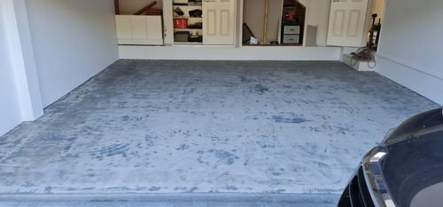

Rocksolid Universal Bonding floor primer complete. Wait as per instructions to apply top coat.

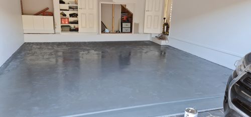

Rocksolid top coat and vinyl fleck complete with one kit. Gave it a couple of days before walking on.

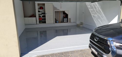

This job was completed 12 months ago. I can report unfortunately the hot tyres did lift the finish and it's slippery when wet. We are happy with how easy it is to keep clean.
