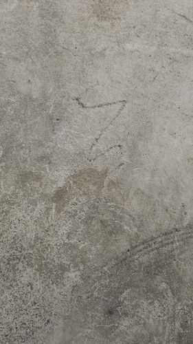

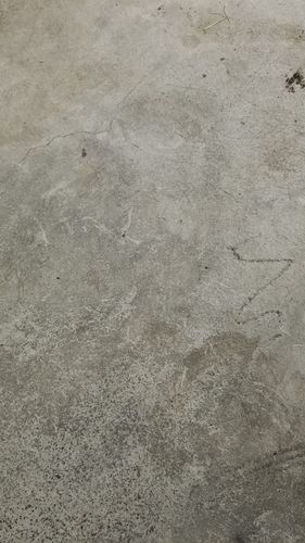

Hi Guys,
Seeking advise on Garage Floor paint or epoxy ideas. I moved into my new home 2 years ago and never thought of doing anything to my garage floor until I found out that it stains.
I have tyre marks, some oil dripping marks and the floor looks different at different places like sides look new whereas the middle part looks old.
I have looked at few options but I am looking for affordable DIY project. I have seen some 1 Part Epoxy paints such as Rustoleum and I have looked at Epoxy Kits such as Dy Mark and Rustoleum.
I am confused as which one is better and easy to do thinking that not all the floor is looking the same and needs a lot of cleaning too. Garage has heavy foot traffic, used for car park and other storage options.
Looking forward for any other suggestions too.
Thank you

Hi @Sajjad,
Your floor condition is fairly standard for most garages, and with some simple preparation, you can paint it successfully. I recommend you follow this step-by-step guide: How to apply epoxy to a garage floor. The Dy-Mark 8L Epoxy Coat Garage Floor Kit has everything you need, including the very important etching agent. Etching the floor ensures it is keyed and ready to accept the Epoxy paint. Epoxy paint is exceptionally durable and resistant to heavy foot and vehicle traffic. Many of our members have used this kit successfully, so I suggest that it would be a good choice for your project. Have a look at @maknilsin's Epoxy garage floor transformation.
For any grease and oil marks, I suggest you use CLR 750ml Grease & Oil Remover and a stiff bristle broom. You'll clean the garage floor thoroughly with the product prior to the etching stage. Check out this helpful guide: How to remove stains from garage floors.

Hi Mitchell,
Thanks for your detailed response. Just one thing on this.
I have some line cracks in the concrete, not deep but long. Do I need to fill them up or just do epoxy over it?
Thank you
Re: Garage Floor Paint/Epoxy
Hi @Sajjad
If you're going for a very nice flat finish, I suggest filling in the cracks with Earl's 1kg Concremate Expanding Cement in combination with Craftright 5-in-1 Scraper. My number one tip is to make sure that the cracks are thoroughly clean and free of loose debris.
Please make sure to give the filler enough time to cure before you begin painting your garage floor.
If you have any other questions, please let us know.
