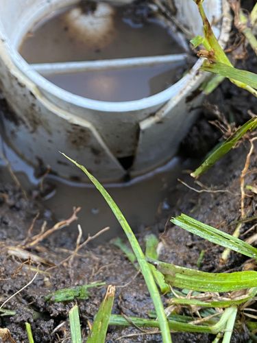

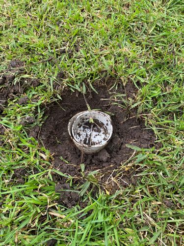

i need help regarding i pipe i just found in my backyard , it is two pipes (doubled up ) outer pipe is demaged got a crack but the pipe inside is all good , does anyone knows what this pipe is for and do i need to leave it exposed or i can put a cap on and cover it up with soil again ?
Thanks in advance

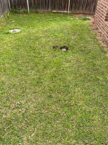

I'm not really sure what's going on there, but I suspect it might be linked with the other drain/grate in your yard. At first glance, it doesn't really look like just two pipes doubled up that are open. What's in the top there that's blocking it? Could it be some type of internal cap pushed into a damaged pipe? Can you pull that section out to open the pipe?
Given that there doesn't appear to be any inspection outlet on top of the pipe, I'd imagine you would be fine capping it. Whoever did the work on it obviously didn't intend for it to be regularly accessed. If you can open the pipe and run a garden hose down it, you might be able to detect that water through the other inspection outlet/drain if they are connected. If that doesn't work, run the hose down the other grated drain and see if you can notice the water in the mystery pipe. If they are connected, I'd say it's just remnants of a legacy system that should have been capped off and buried.

Thank you
the pipe inside is very tight i dont think it can be opened or remived and i have checked the pipe by diggind around further and it is in good shape underneath
i just wanted to make sure its not something that needs to be exposed now i will put a cap on and burry it again

If it was something that needed access, it should've had a Holman 100mm PVC DWV Bolted Trap Screw or Holman 150 x 150mm D Square Grate on it, much the same as the other grate in your yard. Without conducting further investigation as to what it's connected to, I can't, unfortunately, tell you whether it's something that needs to be exposed.
Got any house plans, which show the stormwater/sewage pipes in them?

I have  just found a little gap around the pipe
It is a cap and i tried to pour in some water and its going into the the other inspection pipe next to it
now my only concern is to fix the pipe crack underneath dont know if i need to replace this whole pipe or there is a way to repair it as it is and burry it again ?

I presume it's stormwater @vick87.
No need for the pipe to be sealed. The other one with the grate isn't. Unless you have a torrential downpour, the pipe isn't pressurised and can remain open. I'd imagine it is just this upright that is cracked and not the mainline beneath. You could dig down until you pass the crack, expose good pipe, cut it there, and glue on another cap. You'll find it difficult to cut the pipe down lower unless you dig a large hole.
Unless you are experiencing issues associated with water escaping there, if it were me, I'd just put the soil back over it as is. Alternatively, you could try some of this T-Rex 48mm x 1.5m Strong Waterproofing Tape.
