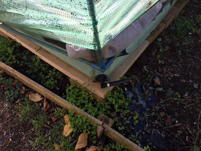

My partner was making a small wicking bed for me however, he passed away two weeks ago. He complained about an abdominal pain, he must have been quite sick when he started making the wicking bed because a week later he was admitted to the hospital and passed away in less than 4 weeks. He was always very thorough, being an engineer, however, he must have forgotten to install an outlet because he was not well. He had made a few wicking bed over the years to grow veggies. Last Sunday, I went out to the garden for the first time after 5 weeks, I found this new bed is filled with water and I am looking for help to explain how I can install an outlet to release the water. Can anyone help with suggestions on how to install an outlet or what do I need to do to release the water. Appreciates any help, Thanks

Can you please give us all a few more details on the bed? Timber? Tin? Is it lined with sheeting or membrane etc.? Does it have a gravel base beneath the soil?
This just determines how we need to approach adding a drain.
And I assume you are meaning the overflow drain? The one that takes surplus water once the 'fill' level is reached.
Thanks Adam, the bed is a tin bed we bought from Aldi, and Athol had used Stones at the bottom, and two types of lining the plastic lining to hold the stones and a mesh lining above the stones. I cannot remember whether he use some pipies/tubes before he put in the stones. followed by compost and garden soil above it. I will go out to the garden to take a photo.
That's correct Adam, the overflow drain appears to be missing.
Thanks Adam and Jason, Sorry for my mistake. When I tried to remove the cover above the wicking bed, I discovered that the pipe will siting vertical to the wall of the bed, which also supports the cover, thus the water was no not release, and when I move the out let down, was able to release the water as you can see from the photo. I panic when I saw the amount of water in the bed and did not see the outlet. We live in Kallista, on the Ridge and it can get colder at night and frost. We are usually 5 - 7 deg colder, but not hotter, which is good. So we provide cover as protection for our plants in the colder months when they are at the early growing stage. Anyone interested in growing and learning about growing your own vegetables or just practical experience are most welcome as we are always happy to teach and share our experiences and the fruits of our labour, what we grow as well. I am thankful for your quick response and I am sure Athol is very thankful for your help too. I know I will not be able to cope with doing all the work myself and would appreciates any help.
