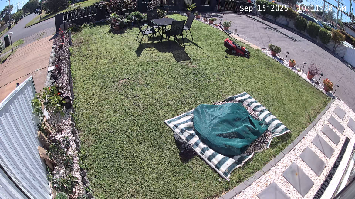

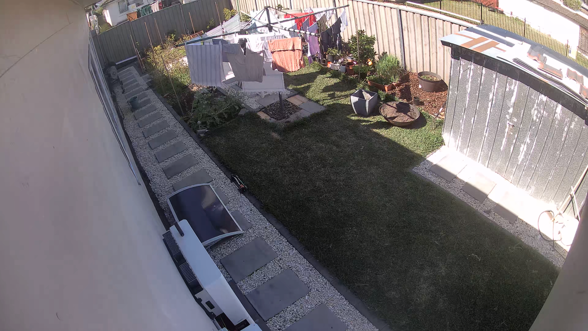

I am attaching the photographs marking the areas along with the plants. Also Marked the Garden Taps.
I have not marked trhe lawn but it is clearly visible in these photographs.
The front yard garden tap my not be useful as there is a concreate driveway and gate in between the garden and the tap.
So in that case, I will need to get the water pipe from backyard.

Hi @VijayWani,
Thanks for providing the extra details and photos. That really helps to get a clearer picture of what you’re working with.
One of the main challenges you’ll face is with the number of pots you have, especially since you like to move them around. With irrigation, every pot needs its own dripper. That means you’d need to run a main irrigation line (typically 13mm poly) and then take 4mm feeder tubes off that line into each individual pot. Each tube would have a dripper or adjustable emitter at the end to water the soil. This setup works well if the pots stay in fixed positions, but it can get fiddly if you move them regularly because every time you shift a pot, you’ll need to reposition or extend the dripper line. For people with many mobile pots, sometimes hand watering those is actually the simpler option, while leaving the irrigation system to handle the garden beds and lawn.
For your long garden beds, a weeper hose is the easiest and most effective choice. You just lay it out along the bed, peg it down, and then cover it with mulch. This way you get even watering directly to the roots without overspray or wasted water.
On your other points:
Water source: If the front tap isn’t useful due to the driveway, then yes, it makes sense to feed the front garden from the backyard tap. You can run a single poly line around the side of the house to reach the front. That way everything ties back to one source, which is much simpler for adding a timer/controller.
Wi-Fi controller: There are plenty of Wi-Fi tap timers on the market now that will connect straight to your outdoor tap. These allow you to automate watering schedules from your phone. Some even allow multiple zones, which would let you run your pots and garden beds separately if you wanted to.
Valves for control: Yes, you can absolutely add manual shut-off valves. Inline tap timers generally handle automation, but you can install simple inline ball valves on the poly pipe to turn off sections by hand. This is handy if you only want to water part of the garden or if you want to temporarily shut off supply to the pots while keeping the lawn and beds running.
