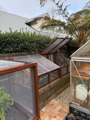

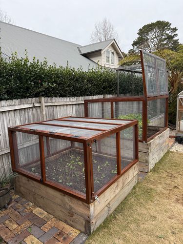

I have had major rodent and pest problems with my garden. After unsuccessful attempts at using cloth mesh which they just ate through I went with a more solid approach building garden cages using merbau battens and rodent proof mesh from Bunnings. I went overboard and lap jointed the wood, hinged doors and on one of them I used gas struts to easily open and close the door. See attached images for inspiration.

Your cages look like an extremely robust solution to protect your plants from rodents and pests. I imagine you wouldn't have any issues with rodents anymore.
The hinges and gas struts would also make them extremely functional and easy to use.
Thank you for sharing.

i have always found these discussions useful and thought it good that I could add some input. For the record all tools and materials except the struts were sourced from Bunnings. If anyone wants some advice on how I built them and avoid some mistakes I made then reach out, happy to assist.
