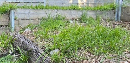

The view from my perch over here is that everything looks in pretty good shape - I see no major structural issues.
The top step is being pushed forward because that wall needs another sleeper.
I propose that creates the illusion that all the steps are being pushed forward.

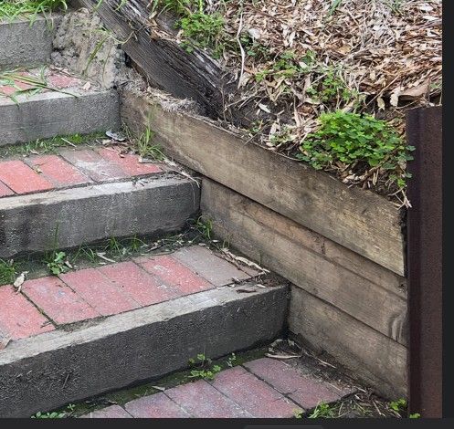

The rest of the steps look ok but do need some alignment work.

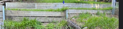

When doing that (addinging another sleeper) line them up with the retaining wall on the right.
Dig out to drop those sleepers.
