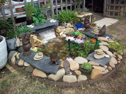

Let's do a comparison with my garden pond suitable for anyone on a budget - even pensioners.
(Intending to post that as a project)
The pond uses a 'standard' clamshell sandpit which holds about 100L of water, features a waterfall and uses the AQUAPRO AP1050 240V Pond Pump with flowrate of 1400L/H. Your pond with the twin cascade will hold about 75-80L of water (much the same) and we need a 12V pump with about the same flow rate.
Pond Pump:
Search eBay for a 12V pump with around 1100L/H flow rate.
Like this one.
