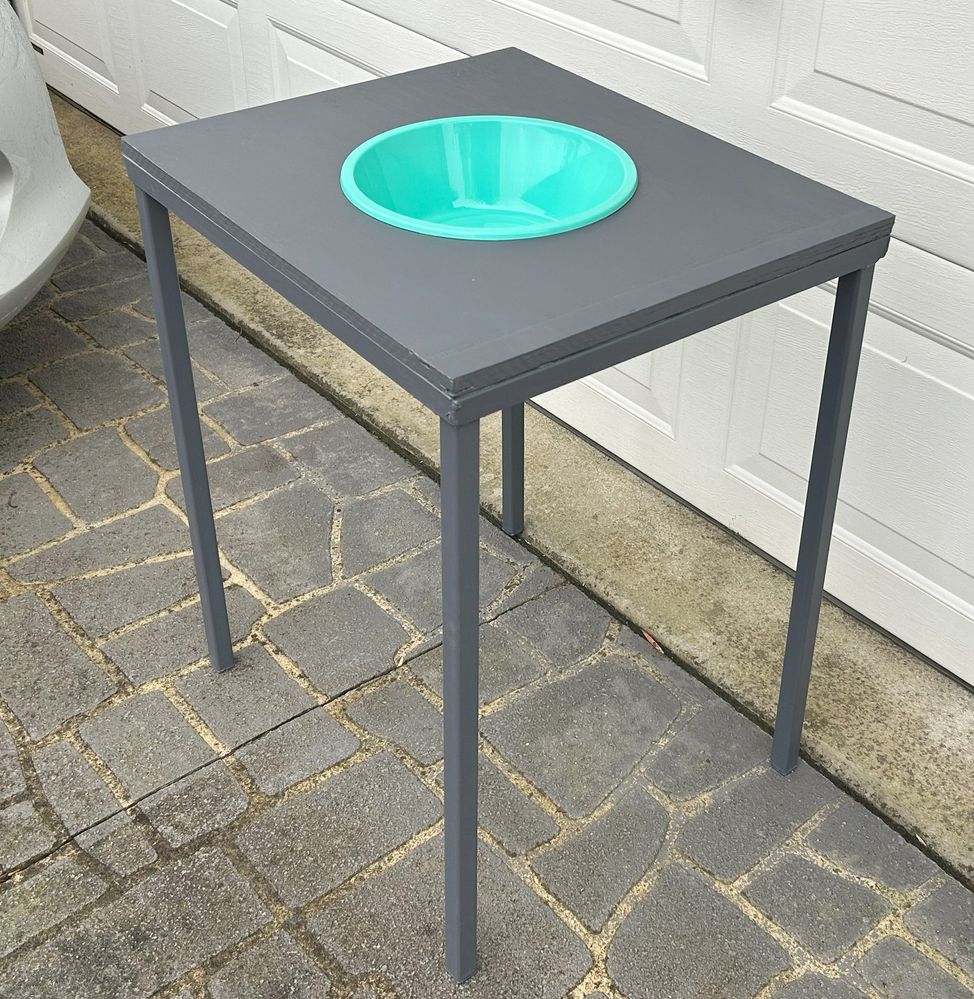

I bought an old table on Gumtree for $1, treated the rust on the legs, cut a hole in the centre of the plywood with a jigsaw and used some left over paint to give it a finish. After that off to Bunnings for a $2.69 plastic bowl and made a potting table for my sister who has some mobility issues.

An old table, Bunnings plastic bowl, left over paint, silicon sealer, rust converter.

Step 1
Found the table on Gumtree for $1 and collected it.
Step 2
Checked for rust on the metal legs and treated it with Rust Converter.
Step 3
Sanded back the table surface to clean away dirt and marks.
Step 4
Bought a brightly coloured plastic bowl at Bunnings for $2.69.
Step 5
Measured the underside of the bowl and cut a hole in the table top to fit the bowl with a jigsaw.
Step 6
Painted the entire table and sealed the inner circumference of the circle with silicon to seal the cut edge once the paint was dry.
Step 7
Inserted the bowl in the table top and delivered the table to my sister who lives with mobility issues so she can continue to pot her plants.

What a wonderfully simple solution! I love how functional it is, and it's at the perfect height for potting up plants. I trust your sister was very pleased with the project.
