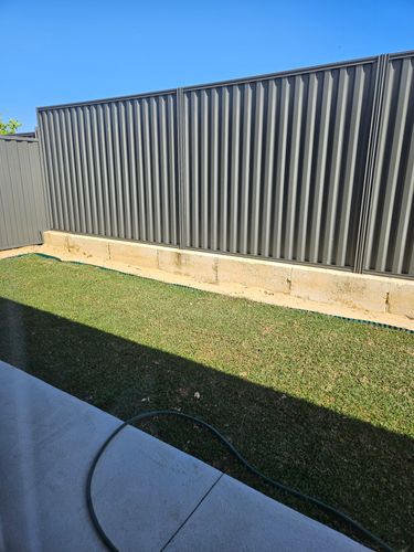

The height I’m looking for is 350 mm, matching the existing 350 mm retaining wall at the back. I’ve attached a photo of the backyard for reference.
I also think limestone would be a good option; however, I’m considering the amount of labor involved, as I plan to do it myself.
Given the grass at the front, there will likely be water splashing onto the timber sleepers, which could shorten their lifespan.20250813_133823.jpg

Thanks for the extra info and photo @Abhi_2691. 350 mm height is a good, manageable size for either material.
Given that height, limestone bricks would offer superior durability and longevity, especially since water splash from the grass could accelerate timber decay over time. The downside, as you mentioned, is the extra labour involved with laying mortar and ensuring a solid, level base.
Timber sleepers would be quicker and easier to install yourself and still look great, but you’d need to accept that with regular moisture exposure, their lifespan may be shorter. Using a good quality timber, adding a moisture barrier or liner on the inside, and directing irrigation away from the sleepers can help extend their life.
If labour is a big concern and you want a balance, you might consider using concrete sleepers—they’re easier to install than limestone with mortar and more durable than timber but come at a higher cost.
