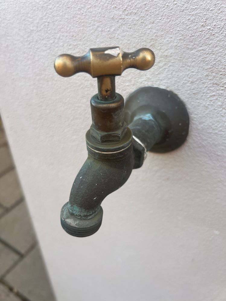

I will send you the photos of my tap and so you know if that would be fitted to the automated remote sprinkler.

Hello Aylie... You do not need to buy an 'automated tap' to replace your existing garden tap. We are discussing a suitable automated watering device that simply connects to your existing garden tap.

No need to replace the current tap @buyurownflowers. The Holman WX1 Tap Timer and Wi-Fi Hub simply attaches to it. From there, you can add your irrigation pipes and sprinklers, which you can control.

Please find my tap photos.
Let me know if it work or I need to replace an automated tap.

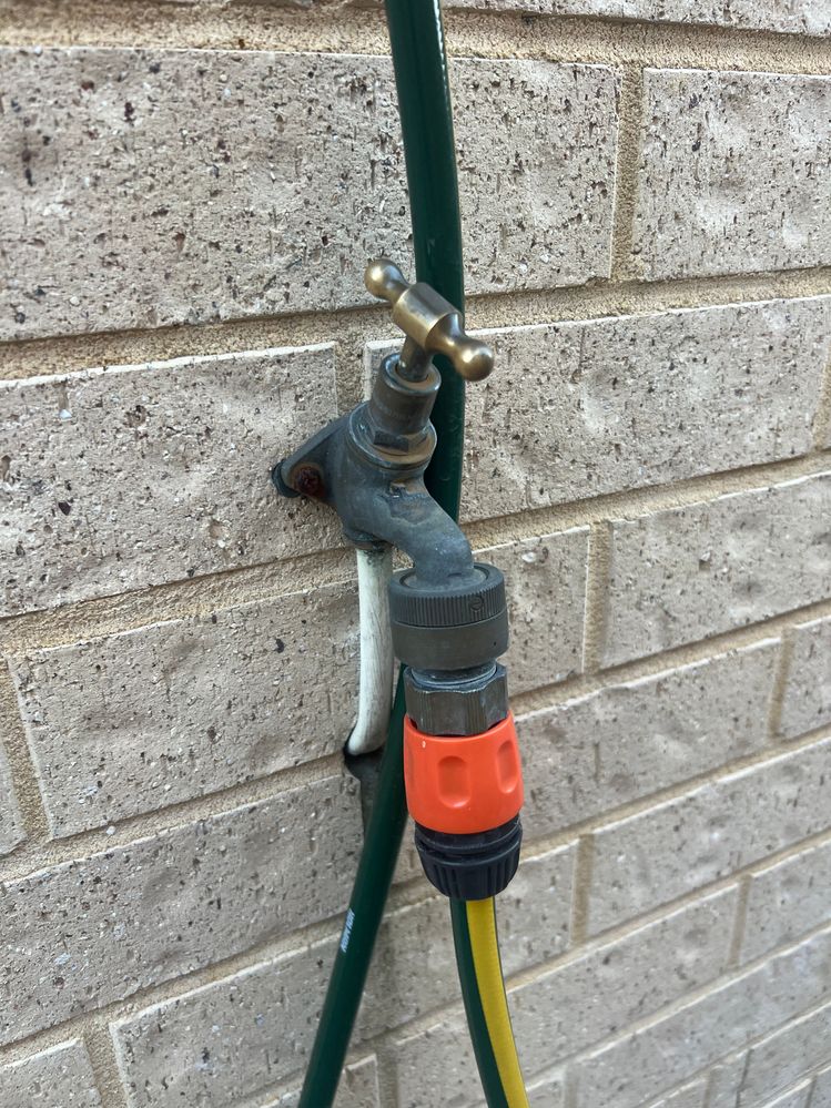

I also attach my tap pictures for your reference.

Thanks for the images @buyurownflowers. The automated tap timer will connect directly to your current tap. No need to replace the tap.
