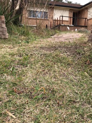

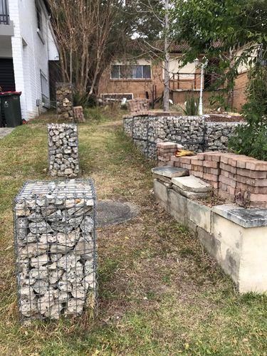

Where the path will be, I figured I would have more then enough pavers 197 of them ish I think (I bought them 4 months ago)

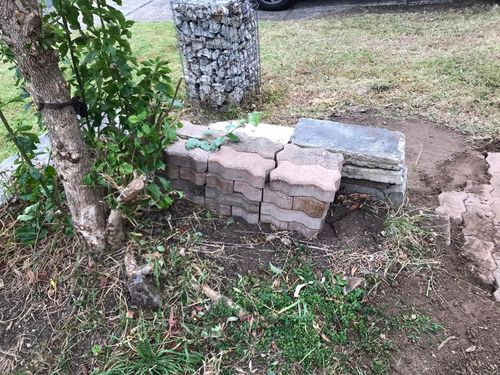

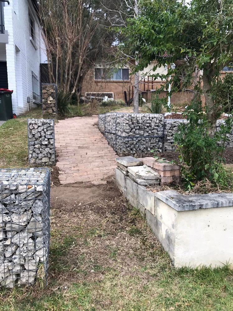

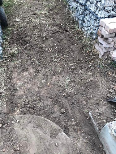

This is where I will have an offshoot ramp for the garden. I grow tomatoes along the Gabion wall.

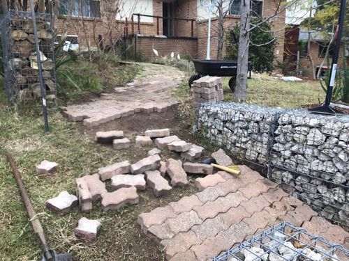

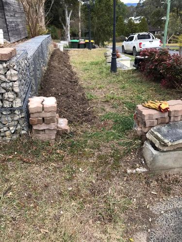

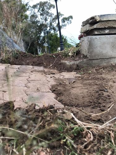

Mmmm Marrying the old path into the new one, wasnt sure to start from the top or the bottom.

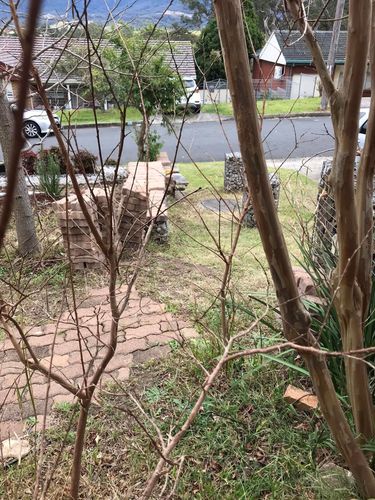

In the end I decided to work from the high side of the sewage access plug. It was something that couldn't be moved so thought that was the wisest.

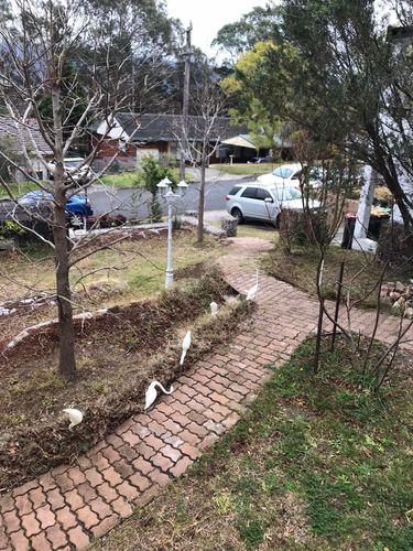

I am actually really happy with how the existing path has held up.

Time to shave the grass out and the clay. Also time to change the width, I was going to keep the same width as the upper path but ended up with a couple of extra pavers width added to it to make it look right

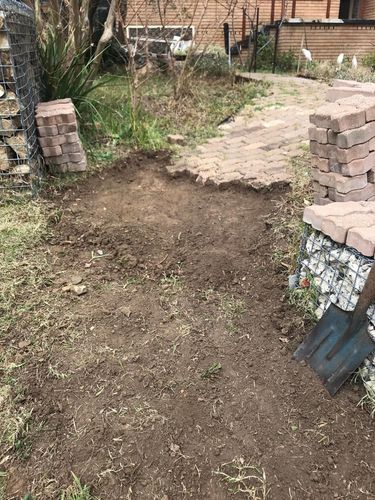

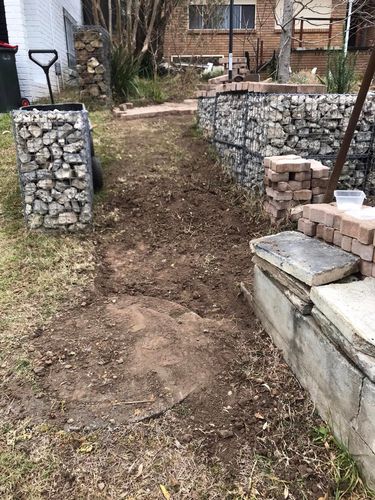

Id worked out the angle of the ramp (and since lost it) and pretty much used my eyesite to keep the slope as consistant as I could. I couldnt cut it too deep as the liquid amber trees roots would be an issue.

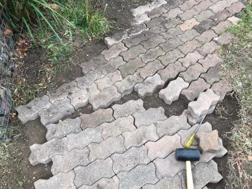

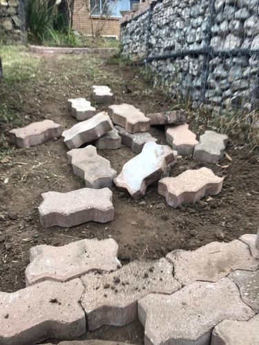

Working from the top until I realised going downhill would be an issue with slippage as I put them in place.

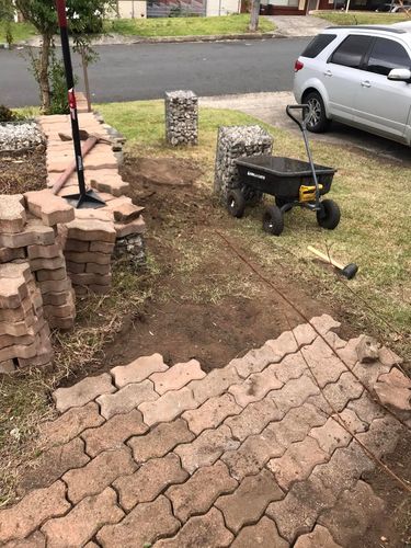

So many pavers, I was burning through them incredibly fast.
The capping works in my favour as an immovable point the bricks butt up to.

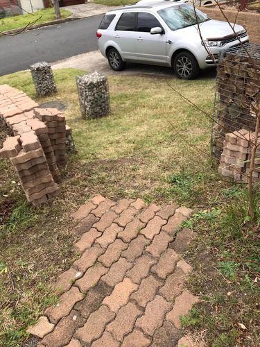

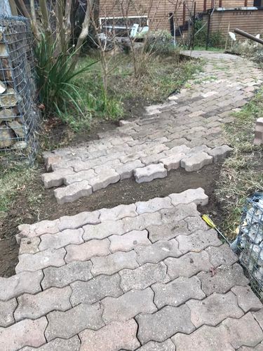

Now to merge the two angles and slopes together....
Almost but ????'s in my mind are starting to turn up..
Bugger... Easy Fix I told myself... Ended up redoing it three times and then there was still a bit of a gap for the merge. I decided to leave it for a month or so as there will be movement between the pavers.

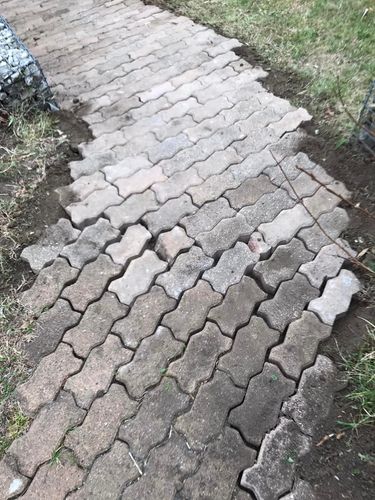

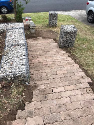

Looks great and was beautiful to walk on. At the bottom you can see the bessa blocks are in the way.They will go eventually and the path will go to the boundary.
This was all I had left, not enough to go to the boundary so project is on pause again until I source some wiggly pavers.

I was really happy with having a second paved access back to the front of the house. Think its been 4-5 years since the front path was removed at the start of sewage works.
Pretty nice, between the gabions one day will be timber lengths to better delineate the boundary. (also to keep doggos in the yard )

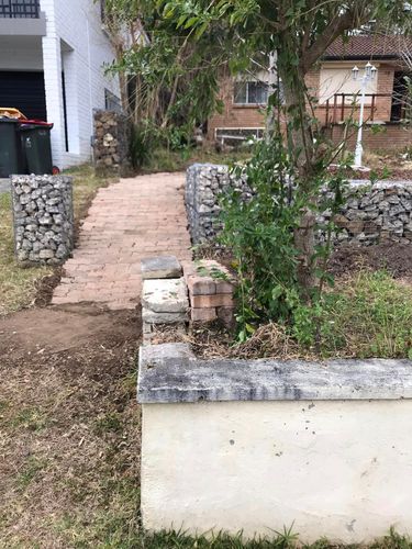

Just to show how much of the retaining wall will go.
The difference in height between the sewer cap and the first terrace. You can see the garden bed and gabion retaining wall on the left. Once those bessa blocks go this will be a smoothish ramp.
