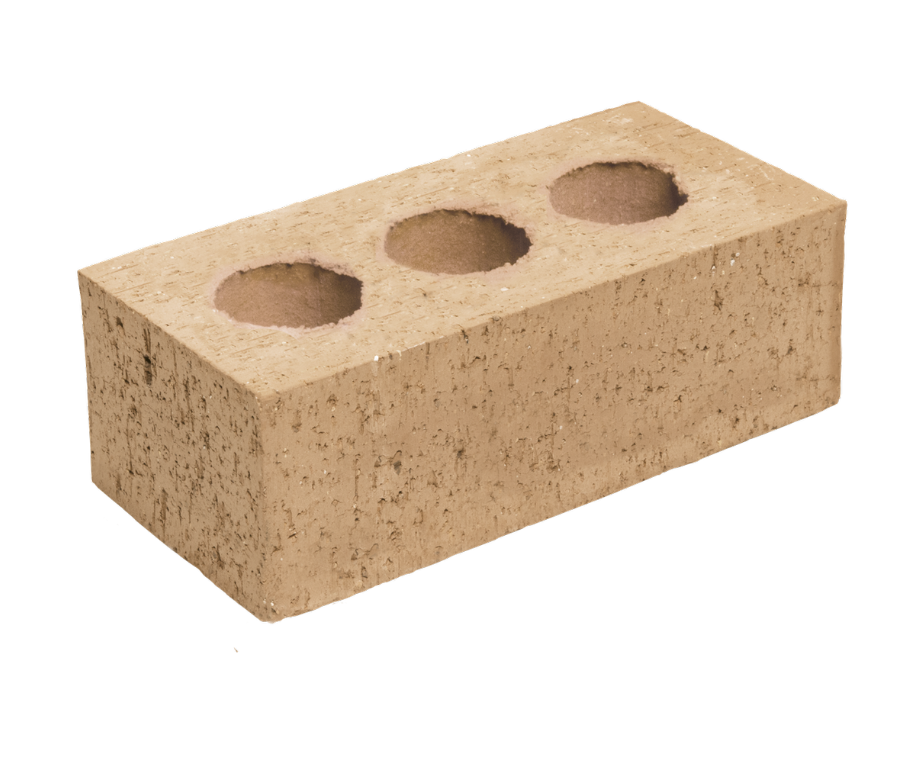

Just to clarify, are you talking about clay bricks like these?
