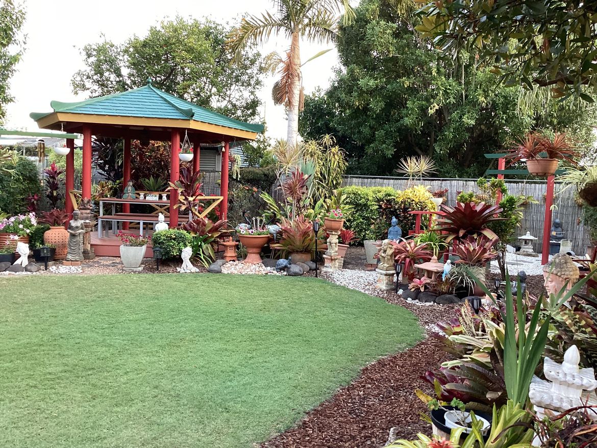

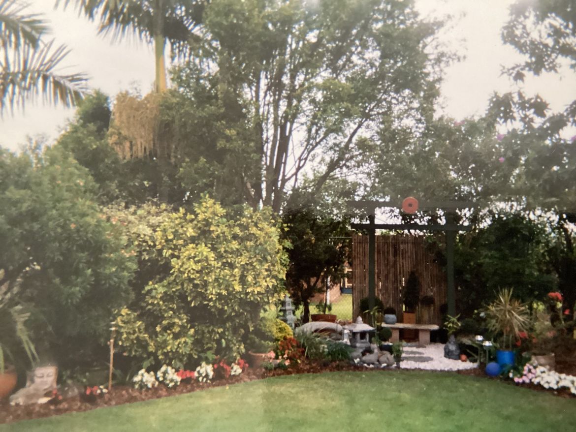

The backyard was originally garden beds made up of plants and trees surrounding the lawn. However, at one end of the garden bed was a Tori gate leading into a small Japanese garden. I drew inspiration from this to transform the backyard into an Asian theme. I needed a focal point so I built a gazebo at the opposite end alongside the garden bed which consisted of plants, stone pathways, statues and a bridge that connected to the Tori bridge.

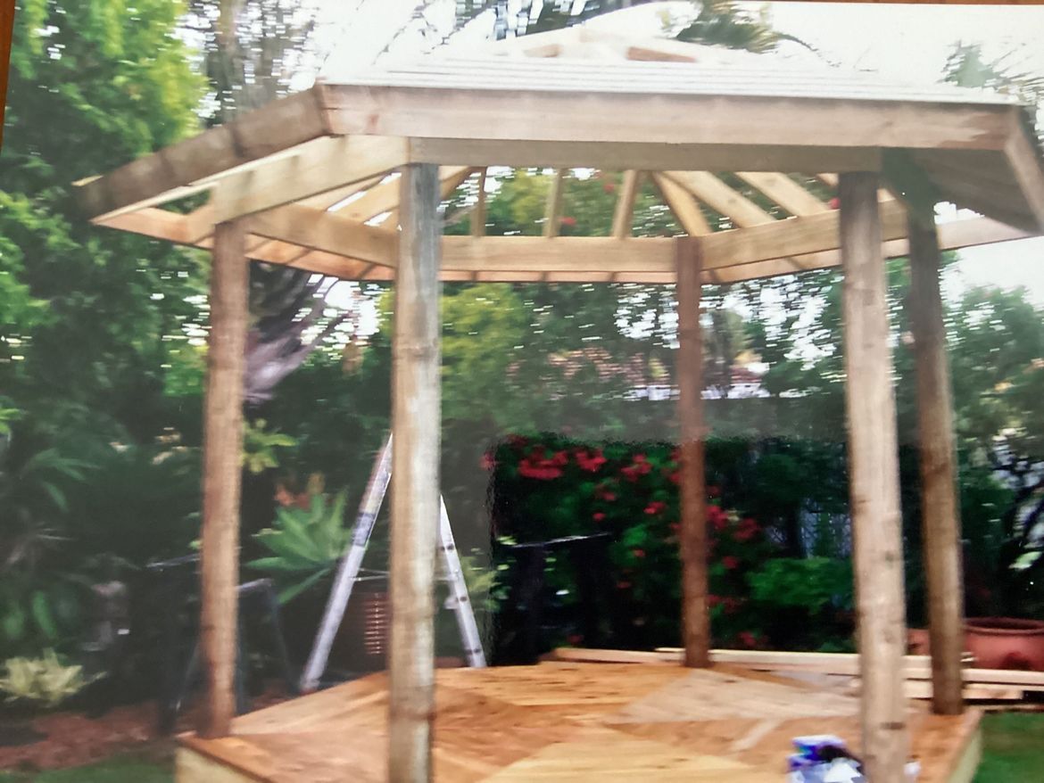

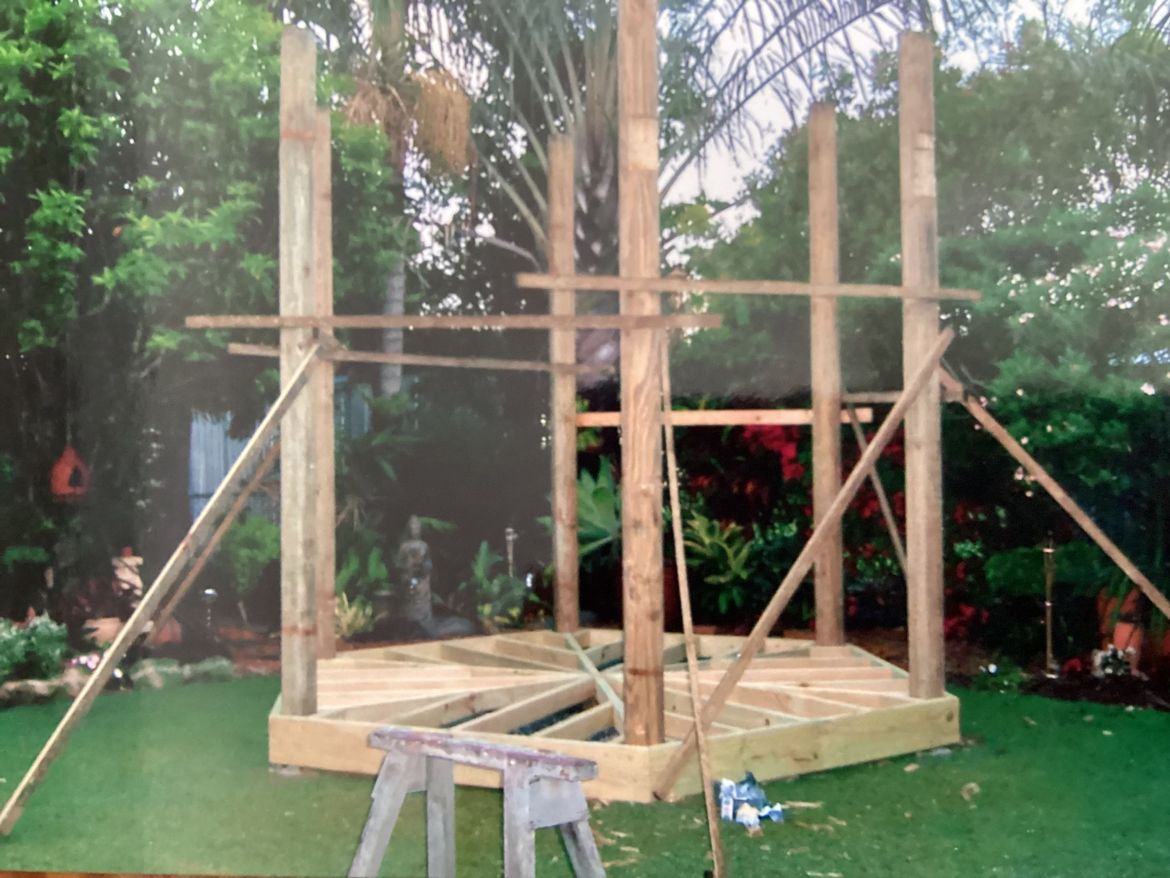

Prepare site, kill grass, lay gravel at opposite end of garden bed and dig hole for posts.
Step 2
Secure posts into holes and build base for floor.
Step 3

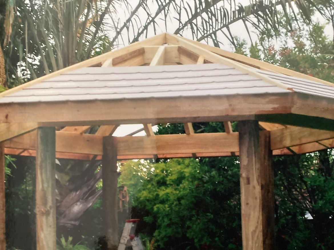

Create floors and build trusses for roof.
Step 4

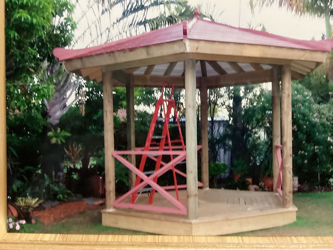

Install roof cutting shingles into roof sheets.
Step 5
Build side rails. Paint gazebo

Finished gazebo using Asian inspired colours.
Re: how to build a gazebo for an Asian inspired garden
Hello @S15-C
Welcome to the Bunnings Workshop community. It's sensational to have you join us, and thanks for sharing your asian inspired garden.
Your gazebo and garden look absolutely stunning. The gazebo itself creates a perfect focal point with its vibrant red posts, green roof, and traditional Asian-inspired design. It feels both welcoming and serene, offering a peaceful place to sit and enjoy the garden. The way you have arranged the statues, potted plants, and stone features around it brings balance and harmony, making the whole space feel thoughtfully designed and calming. It’s a wonderful transformation that beautifully blends structure, nature, and culture into one inviting backyard sanctuary.
