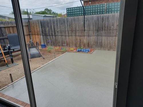

 Hi. I am wanting to lay instant turf between the concrete and the garden beds which have been edged with 200mm wide sleepers. The area is currently covered with lilydale toppings. Obviously I will need to add soil, but I'm wondering if the lilydale needs to be dug up. Thanks

The general steps are to prepare the area first; it will be necessary to remove the Lilydale topping so that it does not interfere with the roots of the turf. A layer of lawn soil and conditioner will need to be added to the surface of your current soil this will give it a good foundation. Since the area is not so big you should be able to lay the turf down in a short time. My best advice is to lay the turf down as soon as possible and let it sit on top of one another.
