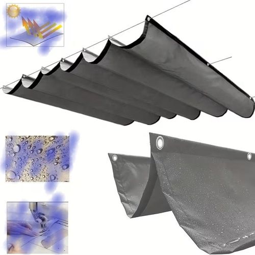

What is the size of the two areas and while waiting for you come back with that I am working on a retractable shade mesh idea.
That uses star pickets or round pine poles and stainless steel wire rope.
Back soon...
