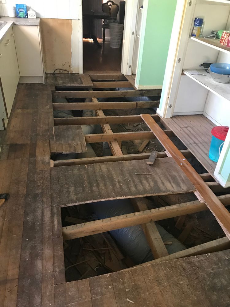

need help with kitchen floor gone rotten and floor people say it is got moister on the timber floor
burnman
New Contributor

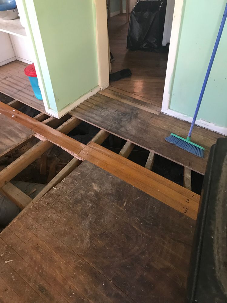

floor gone rotten and floor people say it is got moister on the timber floor cant be sanding the floor and it is 1962 house what can i do i try to find right timber i dont know how floor rotten water in timberfloor rotten water in timber545 002.JPG

Do you where the water problems have originated? Have they been addressed? It would obviously not be a good idea to replace the flooring without tackling the plumbing issues first. If you could provide a little more information I'm sure our members will be happy to assist in any way they can.

Hi @burnman
Thanks for the photos at a glance I would say the underfloor heating has caused Condensation->Moisture-> Rotting floorboards?
All floorboards will need to be Removed, Dried & Salvage what you can, Then try timber salvage yards, insulate between the joists, put down a Damp proof Membrane
before you put the new floor down. Watch this video here
