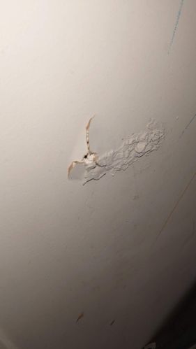

Came back to the store and spoke to another staff. He said the plastic ones are not good enough. Suggested I use the metal one which is stronger and more durable. With their recommendation, I bought https://www.bunnings.com.au/ramset-m5-x-9mm-plasterboard-hollow-wall-anchor-4-pack_p2260148. The problem with this one is that while the anchor has 2 holes to use the screws in, it's too close to use 2 metal ones. But they said it should be ok as it can handle a heavy weight and should be durable for the purpose.
But alas, it also came off the wall after a couple of weeks. And because of how wide it spreads inside the wall, it damaged the wall pretty badly. You can see the patchwork from before next to the new hole.
hole in wall
