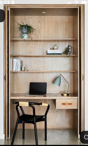

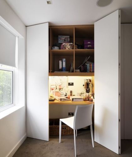

Hi I would like to build a small hidden study nook in the corner of my apartment lounge. See photos for style/look
Ideally it would fit seamlessly for a built in look to:

To start with, since there’s no existing cabinetry in that corner, you’ll essentially be creating a custom-built unit. Most of the “hidden” study nooks you’ve shown in your photos are either in alcoves or flanked by additional cabinetry to give them that built-in, seamless look. If you’re only installing a single standalone unit in this corner, it will likely read more like a cupboard with a desk inset rather than a fully integrated built-in.
For parts, the simplest approach is to work entirely custom. Standard pre-built cabinetry won’t usually work because most come with kickboards that prevent a chair from sliding under, and the panel widths and heights you need won’t line up neatly with off-the-shelf units. A custom carcass gives you control over all dimensions. For the main structure, wide white-coated laminate panels are ideal for the sides, top, and any vertical sections as they’ll give a clean, built-in look. For the desk surface and shelves, you could switch to a multipurpose timber panels to create contrast and durability where it matters.
