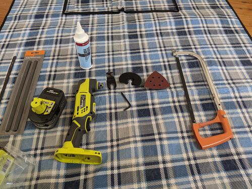

Question 1- If you have a hand saw I would use it to cut the required section. that way the edges will be much cleaner as for the curved section I would use a coping saw or something along those lines perhaps @MitchellMc can let you know what they have available in store.
Question 2 - the putty knife is to apply the filler after the new section is glued in place
Question 3 - Liquid nails is too thick and will not allow the packets to sit flush where the PVA allows for a bonded / flush finish. Ensure you remove any paint of the three packer strips other wise the glue will not work.. (you can turn the packers over and use the un painted side for the packers)
As for Question 4 I do not use that brand of tool hence unable to answer this question I will assume it is screwed in place???

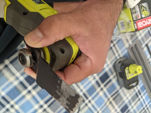

I think using the sanding head with coarse paper (at first) on the multi tool would be safest for cleaning up those edges. Or a block of wood with sand paper as 23ron suggests. A chisel can cause much damage & gouging if used incorrectly. The attachments to the tool should not be coming loose under any circumstances. They fit with the small prongs on the tool going into the small holes in the attachment, so it all shakes together, then the screw down the centre is tightened firmly using the supplied key (aka "Allen key"). Put it in vertically (long end into screw head) to spin the screw down until it bites, then turn the key around so the long end sticks out to the side to give good leverage to tighten it firmly.
Here's a short video... note that the guy almost puts it on upside down at first, plse make sure that you are fitting yours correctly (it may look slightly different to yours).
If you have a hand saw use it to cut the new panel edges, if not, the semi circular saw on the multi tool can do it if you go carefully. First cut the outline with a knife blade, this will give a cleaner edge no matter what saw you use. Tape or clamp the template to the new panel , so any slips while cutting will only be on the bit you are discarding.
PS: don't be using the long bladed saw attachment with the multi tool for this type of cut. The semi circular blade gives a more stable direction for long straight runs. The thin, long one is best suited for "digging in", such as cutting out notches. I think I recommended that blade for removing the panel in my first post on this subject.)

I did the sumilar thing but didn't remove it out fully as my attachments are not full ring just half....but will try removing the screw fully and attach the trianglur head to clean edges
I used the small straaight head yesterday

@TedBear , I haven't done much since otherday, been busy with work. So Honey comb is still intact ( 2nd pic)

Tomorrow I will try to use the triangular head to sand the edges but I have a hut feeling that the head will keep coming off...

@newfast it's handy that the other crack is at a place where you can get at it by making a hole through the inner panel. Masonite is a common product... is there no other supplier near you? If you use the PVA glue it is easier to cut through with a knife if you make a mistake than Liquid Nails (thicker but stronger) and doesn't set quickly (thus the need to clamp it while it sets), so you can adjust things as you go. That head should not be coming off if fitted carefully. The damage to the holes in the photo you supplied suggests that the blade was not sitting onto the locating pips on the tool when it was tightened down. It may be safest to remove the anchoring screw completely and see that the head is sitting down on those lugs fully before putting the screw on. Tighten it down firmly and it won't come loose. (If it does the machine must be faulty.)
