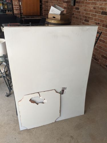

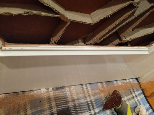

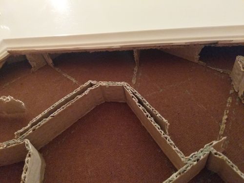

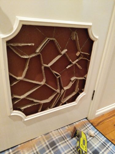

This time sanding head didnt come off and done the sanding with bit trimming of honey comb

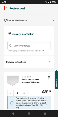

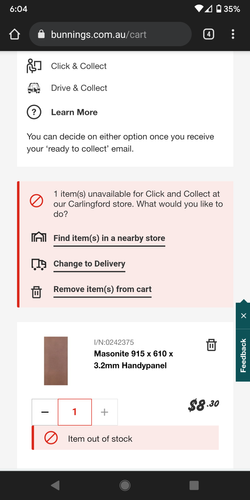

none of the masonite product available @ the closest bunnings and I ordered the closest description but will return if not suitable. Thank you for pointing out, appreciate it.
@EricL @MitchellMc - you guys gotta nudge Carlingford store to keeo more stick lol...everything I touch is not available. I also had to substiture ur provided screw item..NA @carlingford store.
just an fyi....delivery of the last one is $40
It looks much better now you've sanded the edges. Relieved to hear that the attachments are staying on the Multi-tool. I had a look at your model at my local store and noticed that it only has 4 lugs to locate the head, so it will be crucial to get the heads on accurately, as you have now found. That's disappointing that it costs so much to get the masonite delivered. Have you tried asking neighbours if they have any left one Masonite? I always have some in my leftovers corner, so maybe others do too. (Sorry, I am not in your area. )

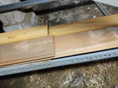

in my garage, I got few types of wood pieces but not the size or tyoe we need

I have only just received the photos of the sanding it has come up well. make sure you cut the new section larger in size so you can sand back as need for a good fit

Re Order - I have collected my order but required masonite item isn't available for click n collect
Hi @newfast,
I've reached out to our team at the Bunnings Carlingford store and called in a personal favour to get this sorted for you. If you phone the store and ask to speak with Ashley, the Click & Collect specialist, she'll be able to work out a payment method (such as over the phone) and organise a sheet of 1220 x 915 x 3.2mm Masonite Whitecote for you to collect from the store.

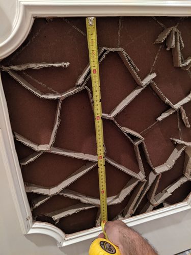

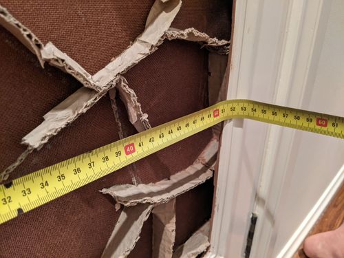

Now tomorrow, I will just place the packers to show how it looks as honey comb may need to be removed or cut strips from masonite and put top mid and bottom.
I wanna get this part right as if I remove honeycomb fullly no going back.
