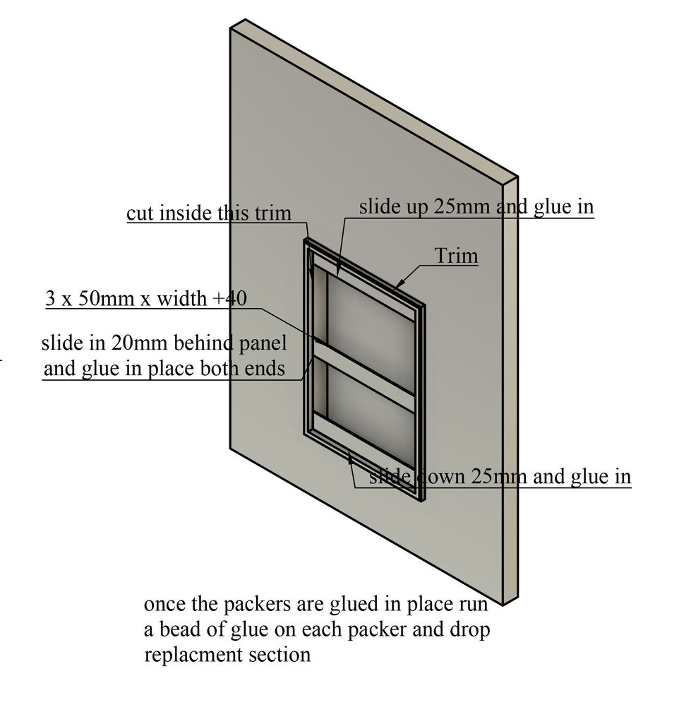

This can be a real simple fix or it can turn out to be a nightmare The first thing to do is to cut the the whole section out and that is dune buy cutting as close to the inside of the trim as possible, the thickness of the masonite does not matter at this stage.
once that section is out you can’t measure the space and make the replacement section.
holding the new section in place is simple. Cut three length of 50mm wide and the length must be 40mm longer than the span of the gap.
you will need two G clamps and good quality wood glue
take one of the length apply glue to both ends slide the that length in behind the front panel so as 20mm on either side is behind the panel this will be at the top clamp in place and allow the glue. to dry repeat the process this time place the next section in the middle of the space glue and clamp in place
With last section repeat the process this time place the length at the bottom of the space
Now you have you packers in place .
cut the replacement section as close to the size of the gap in the door apply glue to each of the packers set the replacement section in place and allow the glue to dry. Fill any small gap with filler sand and paint I will create a sketch for you do not use hard as nails as this will cause alignment problems
You will have to remove some of the honeycombs out of the way.
I hope you can follow this process in the mean time I will do a sketch for you

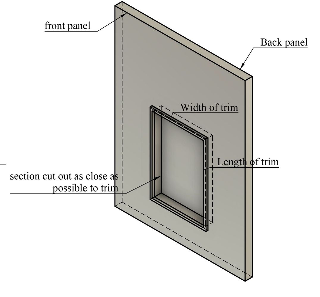

Here is a sketch it can give you a better idea of what I have described above.
I would be wanting to make the replacement section a press fit (as tight a fit as possible) and applying glue to the edges of the this section.

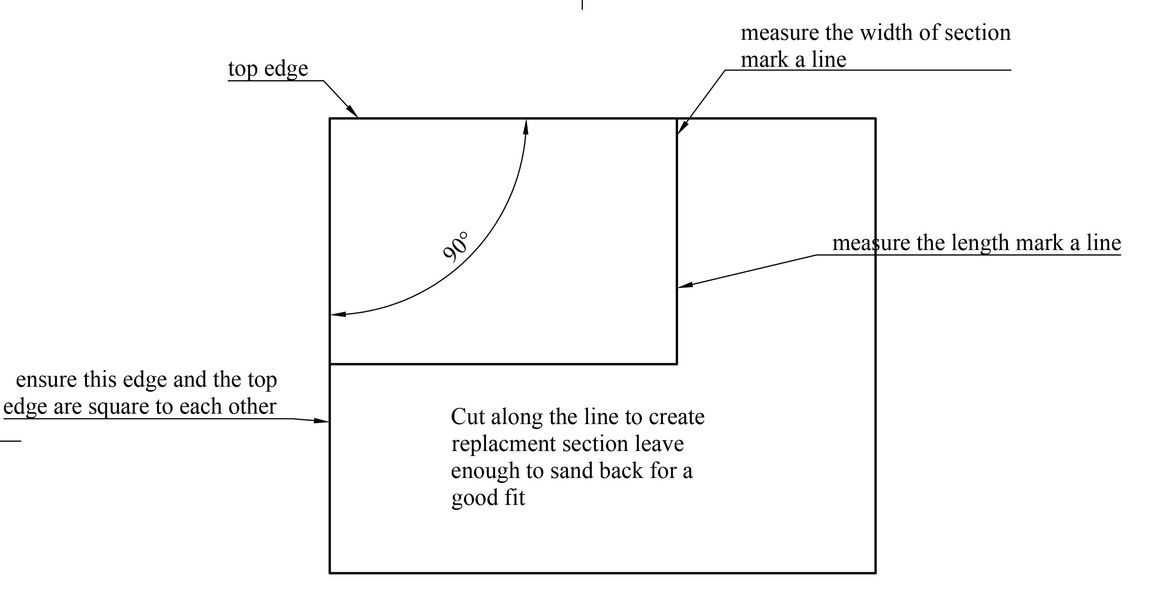

Ok the the problem is not really a problem at all. The three 50mm wide strip are glued to in at the back of the front panel they are now the packers that hold the new section flush. In order to get the correct size that will fit inside the the trim area you need to measure the width and length in side the trim area. with a new pice of masonite mark the width and the length use a square to ensure the lines are square to two edges. then cut to the line, leaving a little bit over size that way you can sand the edges back to a perfect fit. I will endeavour to do a sketch for you
I hope these sketches help

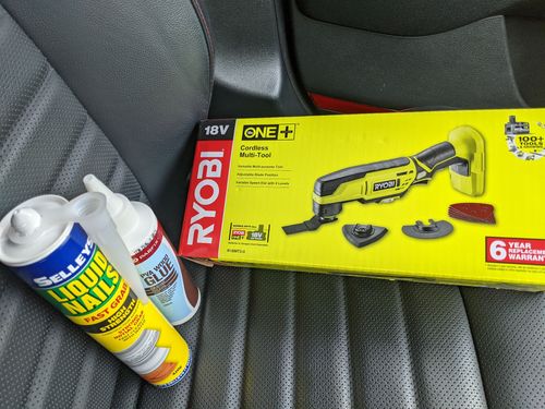

First thing 1st, i bought the plain wood glue, liquid nail and the multi tool. Will watch some videos on how to use/cut etc
But thank you so much everyone.

If you follow the instructions you will not need the liquid nails the The PVA glue will do the job so long as you use the G clamps to hold the 3 strips in place to dry. Point make sure they is no paint on the strip as the glue will not do its job
Enjoy the project and the learning experience, “for those who have never made a mistake have never done anything”.
The other thing you will need is a putty knife and some filler the best to use is timber mate Australian made Australian owned I stress do not use builders bog.
