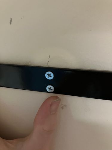

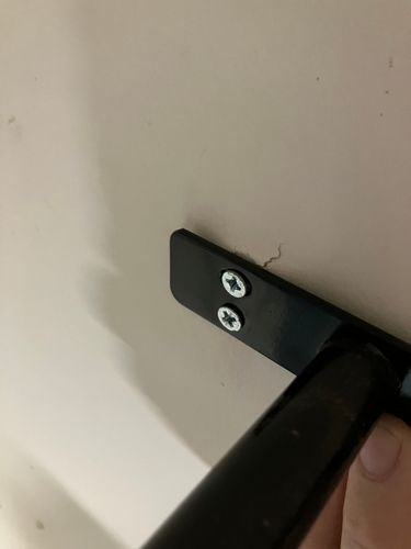

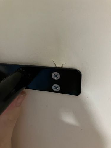

How do I fix my floating shelf, had things on it. And it dropped from the weight, screws were tightened but it’s dropped again and it’s cracked around the brace at the screws in the wall

I'll take a punt and say none of them have as all of the three upper screws look like they're being torn through the gyprock.
May I suggest taking the bracket down and looking at what anchorage fitting is behind it - if none, then probe the holes looking for wood with say a thin piece of wire.
If no anchors or wood, then we need to look at better anchorage and/or locating wood behind the gyprock.

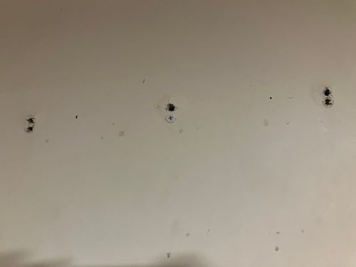

my bracket from the wall and how it was as I removed it

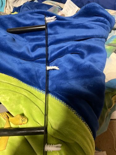

question for you, from my photo of the shelf bracekt had five wall mates if that too much for that shelf or it the right amount? Had it made that three of them would have been fine ?

Looking at the photos of the wall after the shelf was removed, it looks like you'd have been better off with 3 wall mates as opposed to 5.
You can see in the below image that the close proximity of the wall mates has caused the gyprock to fracture between them which has caused them to lose their holding power.
If you were to reinstall the shelf, I would advise you to locate at least one stud and preferably align the central mounting holes with it. You should then drive 2 x 50mm Countersunk Wood Screws into this stud. You can then use 1 x Ramset Super Wallmate Toggle Anchor on each side of the shelf bracket to help balance and support the shelf.
