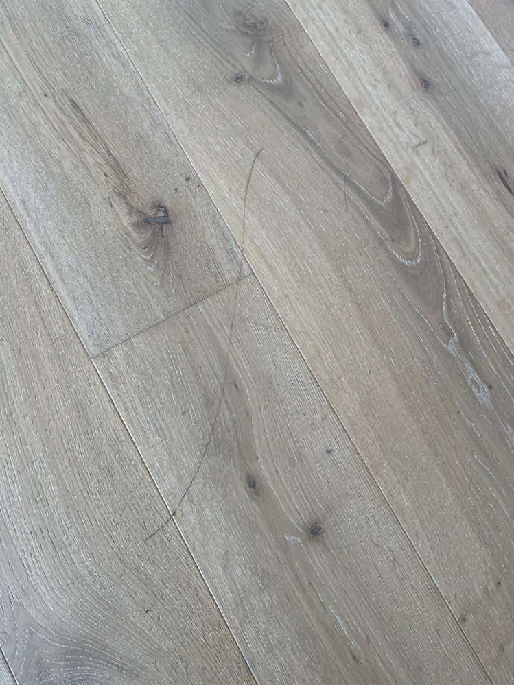

There is scratch on my timber floor as can be seen. Is there anyway this can be fixed or if it can be lightened? Colour of the timber is more yellowish than can be seen in the attached image.

Can you tell whether this is a scratch in the floor that has had grime build up within it or if it is actually a mark on your floor? It looks suspiciously like a mark as opposed to a scratch. In either case, I'd suggest trying to clean it with a damp cloth and a drop of dishwashing detergent. If it is a mark, which I suspect it might be, you could try an eraser pad. It actually looks very much like a mark from a lead pencil; any small children in the house? If it's a scratch that has depth to it, you can try using a beeswax filler stick to add a lighter colour into it.

Thank you very much for the response.You are correct. It was indeed a mark. Detergent and damp washing cloth did the trick. Thanks a lot mate.
