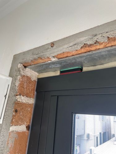

I’ve had our 40-year-old timber windows replaced with aluminium ones, as a result wooden architraves were removed and the galvanized steel lintel was exposed on the indoor side of our window surround.
I’d love to hire someone to render the opening properly and a square set modern finish is what I’m looking for. The only tricky part is how to treat the underside of the lintel so there won’t be any cracks due to movement or expansion.
GPT advised to either screw a piece of FC board in and render over it as normal, or to slurry with some adhesive compound and render on top. Love to hear what you would recommend to do before I blindly turn to someone.

1. Using the instructions in the image below, fix 90mm x 45mm pine to the underside of the door frame using liquid nails and a couple of self-drilling metal screws. Drill pilot holes through the timber first. As noted, the 90mm batten wont be the same depth as what it is from the brick edge to the door frame. But the cement sheet will cover this.
2. Use cement sheet brads to secure a strip of cement sheet to the face of the batten. Then the 2nd flush along the front of the batten back to the door frame.
The area is now ready for rendering. The renderer will fit the external aluminium corner edging angle so, you don't have to worry about that. I do always think it's a good idea if unsure though to discuss what you propose to do with your renderer as @JacobZ also suggested. This is just in case they have another solution to offer.
