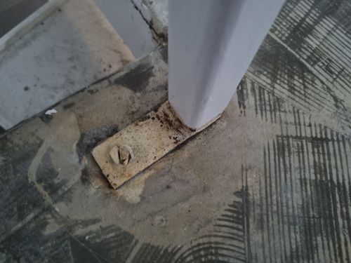

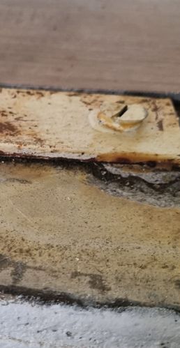

Hi, I'm currently in the process of removing carpet and laying down hybrid flooring. I've run into an issue at the top of my staircase, the way the railing is attached (see pictures).
The planks are about as high as the flat bit, and there's a screw sticking out so cant go over it.
Any ideas on how to get around this/cover it up?

Even if that screw was installed correctly so it was flush with the top of the bracket, it still sounds like the bracket is too tall to lay the flooring over it. Your only option might be to lay around it and paint the bracket in a similar colour to the flooring.
Let me mention @Dave-1 and @Nailbag to see if they have any suggestions.

Hi @Jen10
Can that upright be removed?
Elaborate suggestion I know and It would involve telescoping metal tube, a concrete bolt and....welding.
Just a late Sunday arvo suggestion.

First that Flat head screw probarly needs to be replaced. If thats all thats holdingthe banister... :surprised:  It must be strong. It may be a pain to get out as it looks like its rusted (therefore weakening it also)
How thick is the hybrid flooring plus any underlay?
If its a few mm more then the metal foot, you are safe, if not then two options. Take @MitchellMc's advice as I would be doing the same.
The second is to actually raise the floor area using say hardiplank if its outside or masonite type material if its inside. That way you can recess the foot/screwhead into the underside of the hybrid flooring and hide it. Pretty much like I have showed with the privacy screem for the bolts. Be prepared for a few practice piece stho is about all I can suggest.

It's great that you've received excellent advice from our members. Just to add to the suggestions made. I propose painting the steel foot in white to make it look brand new and changing the screw to a stainless-steel pan head. This will make it look nice even if it stands out. One other option is to paint it brown or the same shade as your hybrid flooring so that it blends in.
