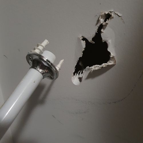

Hi. I slipped over in walk in robe recently, falling onto the lower clothes hanging rod. This has ripped it out of the wall, leaving an odd shaped hole . I am aware of how to patch the hole, but surely it wont be strong enough to support the hanging rod ? I cant put it elsewhere as the other end of rod is still attached to opposite wall. It cant be higher as it will be in the way of clothes hanging on upper rod. Any lower and clothes would drag on the floor.. what should I do? I thought of removing a large section of plaster and adding a noggin between existing studs... is there an easier way? Thanks in anticipation. Photo attached.
Because it was an accident and unlikly to happen again I dont think you need the full nogging support and if you did the other end might go instead.

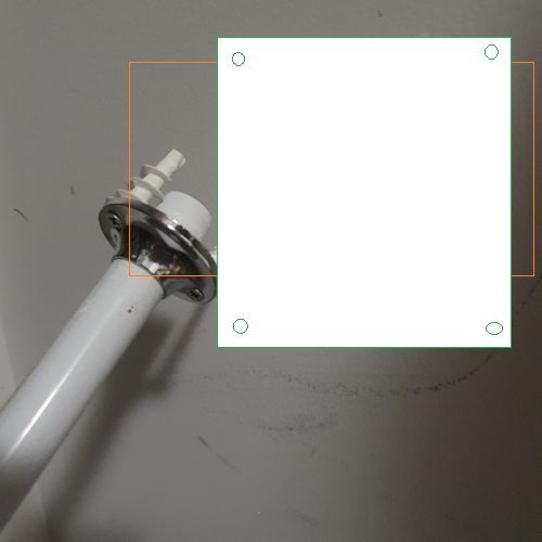

Fix A
Its great you can patch the hole. Now lets say you cut the ragged hole to a square shape now cut a piece of repair gyprock to fit loosly in the hole to the same square shape. Now we need to cut a piece of scrap timber (marked orange in pic) 6xmm ply thick up to say 19 mm timber board the shape and the size is going to be longer inside the wall to span across the hole but narrower to fit through hole and glued and screwed inside the wall as a plate.The orange timber can be any angle or vertical. This is you plaster re enforcement for mounting the repair on to. Then you can screw glue your new gyprock plate on top of the timber support and start using the plastering mesh to cover join gaps and apply gyprock plaster and you know the rest.
Orange timber behind gyprock
Plan B no gyprocking Simply cut a square of timber the white square to cover the whole of the hole and a bit more and glue it with sufficent room around it add 2 to 4 screws to hold it to gyprock. You may need to trim rod length down a bit depending on wood thickness. Or drill out timber to fit rod into directly into timber hole no screw mounting ring required.
Ps I would turn the square 45 degrees to make diamond shape or cut out a love heart shape if you want to be crafty but then you will want one each end.
Have fun

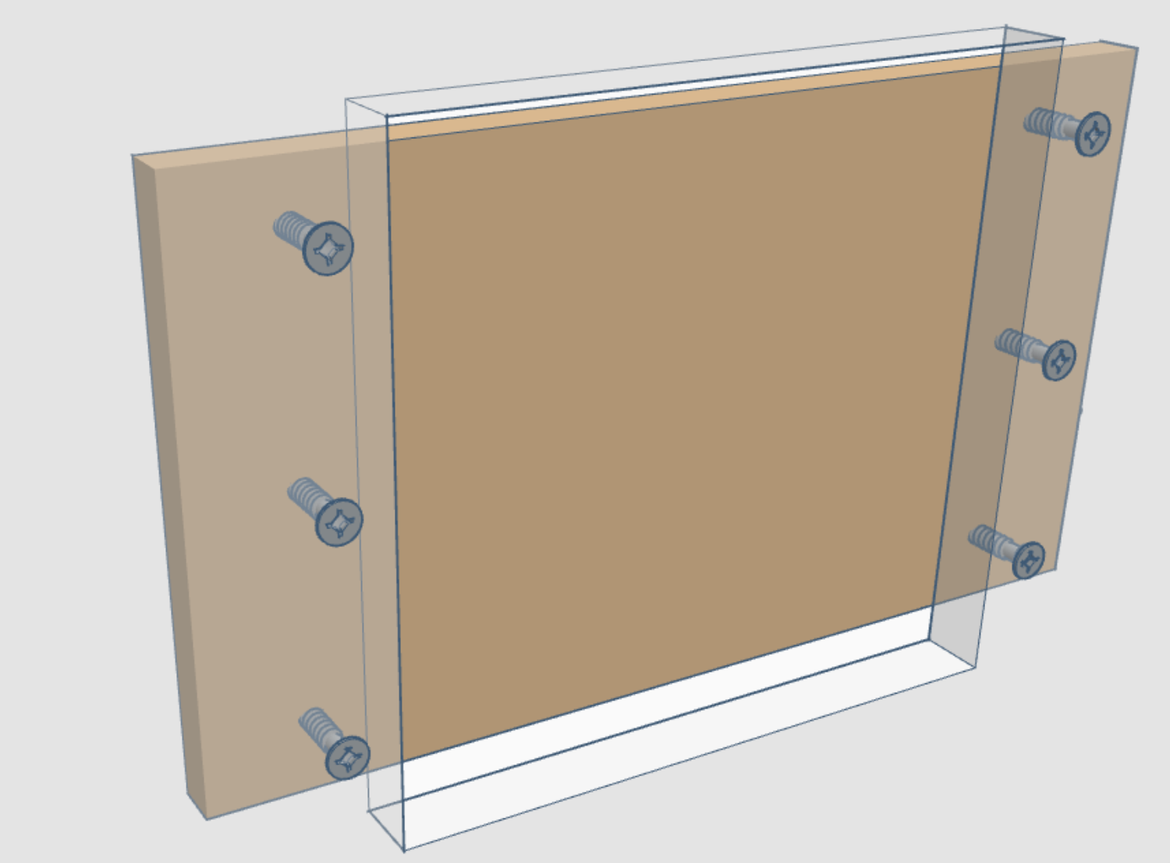

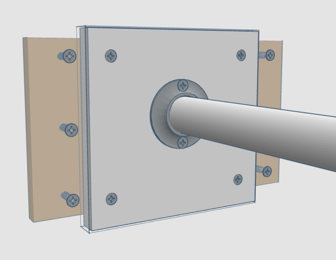

I'd agree with @Jewelleryrescue . Timber section behind the plaster, and then a cut section of repair panel plaster glued and screwed onto the timber to fill the hole. You'll then need to use plaster filler to cover the screw heads and gaps. I've put some renderings together for you to help illustrate.
Just a square of timber screwed over the hole would likely do the job in a pinch too.
