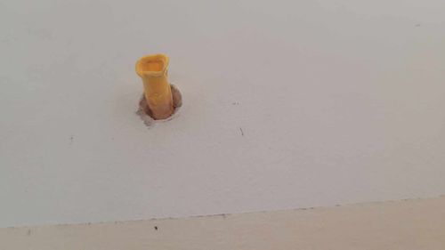

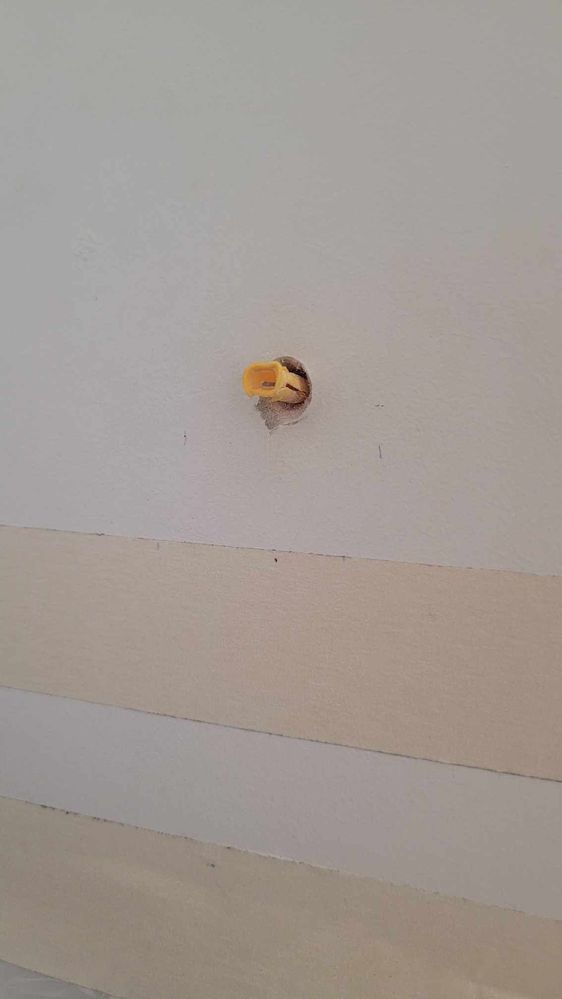

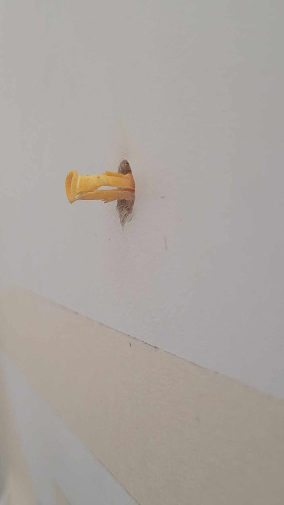

Bought some coat hooks and it came with these plastic wall anchors. I tried installing the wall anchor but it wouldn't go all the way into the wall after hammering. And when I tried to remove it, half of it is stuck inside the dry wall. The plastic material is also slightly damaged, bend. I tried pulling it, using pliers, drill, using the hammer claw, it all didn't work.
Any advise would be appreciated, thanks.

It sounds like the plug just needs a bit more force to be removed. Try using your pliers to grip it firmly, then place a small block of timber against the pliers. Instead of pulling straight out, lever the pliers over the block. This creates a fulcrum point and multiplies the force applied, making it easier to remove the plug.
If that doesn’t do the trick, you can also use a timber or metal drill bit slightly smaller than the hole to drill through the centre of the plug. This should shred the plastic enough for you to pull it out in pieces.

Don't struggle just drill it out with the same size drill bit you drilled the hole with in the first place.

The solutions proposed didn't work unfortunately. The wall anchor part that sticks out of the wall is too flimsy to hold and slightly damaged.
Any other ideas on what I should do?
