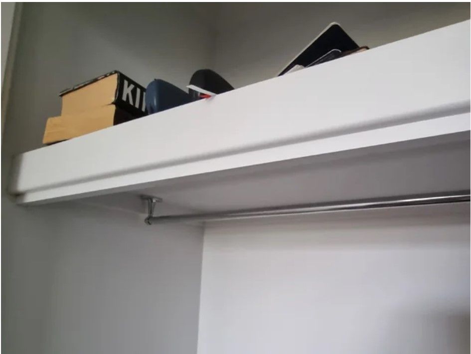

I'm considering doing a walk in robe makeover. I would like to ask if anyone knows how to remove the wardrobe shelf like the one in the attached photo? Any pointers as to how to go about removing it?

You're in luck as we recently had a conversation about this very topic. I suggest having a quick look at this discussion - How to remove a built-in shelf? by @johnpyt. The general installation technique is that the screws are cleverly hidden on the shelf itself. It could be filled over or covered with paint, one way for you to detect them is by using a strong magnet. Simply run the magnet slowly over the side supports of the shelf and you should be able to detect them. You then remove the screws using a screwdriver or a cordless drill.
