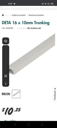

I swear by this stuff. It hides everything and leaves your walls looking neat. Just make sure to use heavy duty double sided mounting tape. I run all my network cables through it. I wrap the turns in white electrical tape so you see no ugly colored cables poking out.

I wouldn't use trunking unless I really HAD to, it just looks the person that did the install couldn't find a better solution.
Even if I had to use it, I would mitre the corners and keep it neat.
And you always use screws into timber to hold it in place, not the tape that comes with it.
9 times out of 10, you can see this stuff in a house and the tape has taken the paint off the wall behind it and it's hanging down
quite forlornly.
In saying that though, I have used 200mm x 100mm trunking above switchboards and control panels, that's a different thing.

I agree it's not the ideal solution, but for ease of use and installation in a rental property this is a good way to hide cables. Can't start drilling into the walls if I don't own the place. But I agree if it is your place then hire a sparky to do it right. My suggestion was based on diy effort and the possibility that it was a rental. I was not inferring that it was the ONLY solution. Perhaps @Sugar can give us more information and a better recommendation can be given. My apologies @MikeTNZ  if my suggestion offended you.
