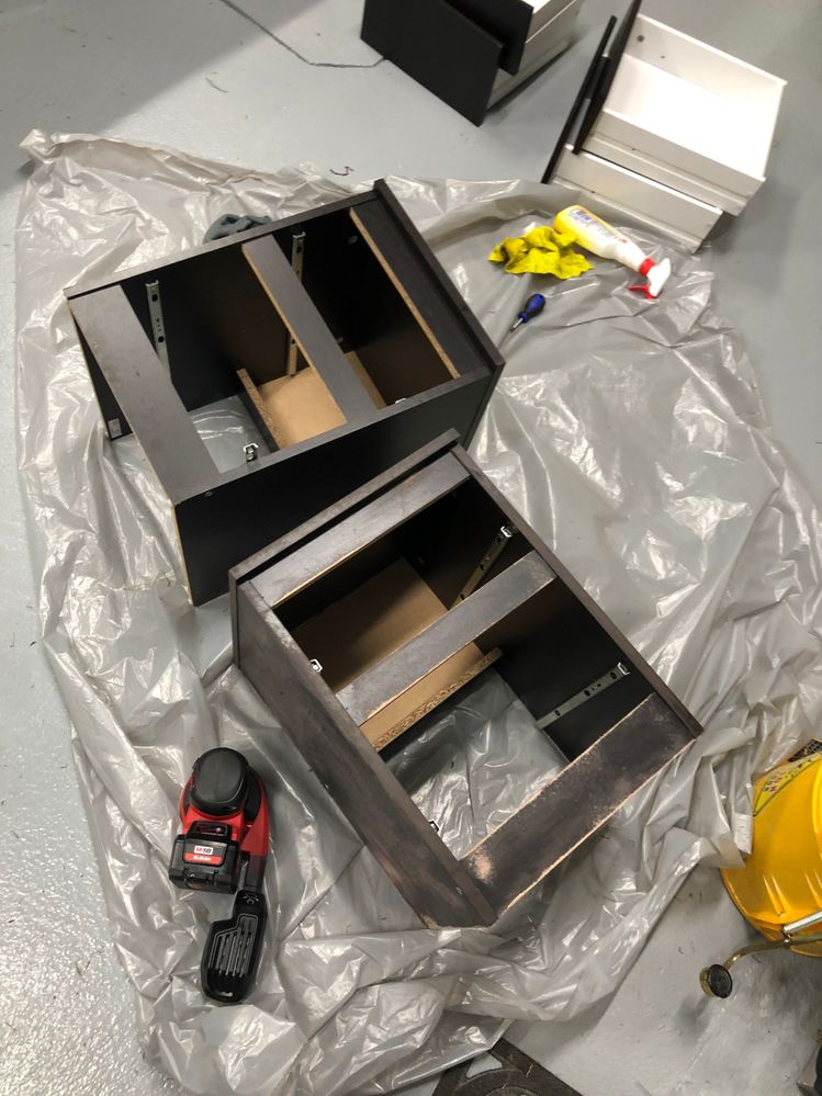

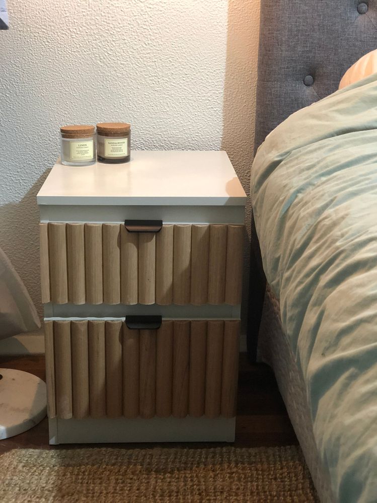

Recently upcycled my bedside tables. Unfortunately I didnt take a good "before" photo, but love the outcome.
This was done with some undercoat & paint from bunnings. Then just glued the dowels on the drawer faces.
after
before

You've done a great job and members will find your project inspirational. Can you take us through your process a bit more? Did you sand and then add undercoat? How many layers of paint did you need to use?

Yes I sanded the drawers first, then undercoated. I've used 2x layers of undercoat and 2x layers of paint.
I got 30x12 mm 2.4m half round tassie oak moulding at bunnings, cut it to size, sanded and just used wood glue to stick them on.
