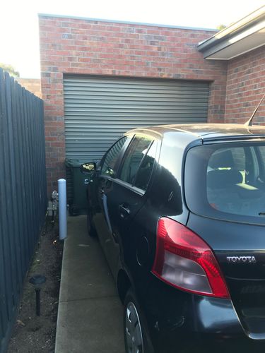

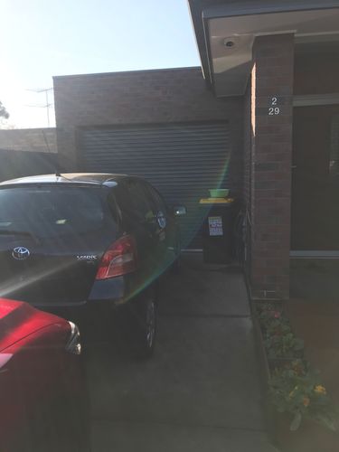

Hi everyone,
We would like to have a sun shade to act as a car port in front of our garage.
We would like to use a rectangular dual sun rail.
however we’ve never installed poles. The Bunnings website doesn’t have instructions for poles. Can we buy poles there and can you provide advice and instruction on how to install poles? And how many poles do we need to have based on our photo’s? Can we get away with two poles?
Front the fence to the home side wall is 3.30 m and from the garage door to the end of the deck is 4.4 meters and we’d like the sun rails to extend at least that far.
Your advice and suggestions would be appreciated.
kind regards,
Ken

Hi @cangarooooo As Mitch mentions you will need solid advice on those posts as a shade sail is just that - a sail - and it catches wind.
Post holes have top be pretty substantial, I'd be thinking at least 500mm wide by 600mm deep. At least.
Also... if you are planning on attaching to the walls of the garage or the home you will likley need council approval and also some sort of engineering scope for that too as a shade-sail in strong wind can tear down the top courses of a brick wall of rip off fascia/barge boards if not properly installed.
Sorry to be a bring-down but it is one of those projects where the impact is often not properly thought about.
