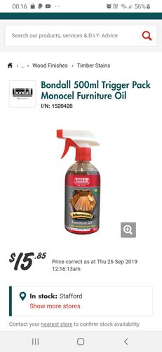

@Former Workshop member Is this the Bondall you are talking about?

@jgsa1967
yep, that's the one... I tooled around my local bunnings, swearing under my breath cuz there was no tung oil - couldn't find a shelf ticket, even. Apparently there was no stock when I checked the site later. Anyway, after much more 'rhubarb-rhubarb' muttering on my part, I settled for this to use on the potting table. We won't go into the manufacturer finish on the table - RHUBARB! However, the bondall worked really well. I wouldn't put it on a table I eat from, (linseed only), however it's been awesome on what I have put it on.

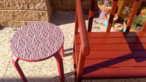

Funnily enough I have had to do just this over the weekend - with some differences.
I found out I was hosting a small party week after next - we won't go into what I thought of that, and how it came about - the main point is I needed some extra seating, quickly. It was sort of good, because we wanted another bench in future, anyway, etc etc.
So I bought this cheap outdoor bench from kmart, because I loved the vaguely Asian minimalist shape it had.
So the colour was wrong, seeing as I have modded ikea stools that I put fabric on etc for side tables outdoors. I have plenty of fabric left for making cushions etc etc.
So instead of buying paint, I mixed some red oxide concrete colour with the bondall furniture oil and some boiled linseed oil... now I just have to apply a few successive coats of bondall to get a nice hard finish. but even with the paint coats, the colour isn't coming off.
Red oxide gives Indian Red colour, which absorbs uv a lot by itself, that's why it was used a lot for barns.
Anyway, point being that this will be great if I coat it once or twice a year with the furniture oil again. Just shows what you can do when you play around. I had some wood sculptures that were treated this way - lasted for years before needing repainting.WIN_20190930_08_33_46_Pro.jpgWIN_20190930_08_30_28_Pro.jpg

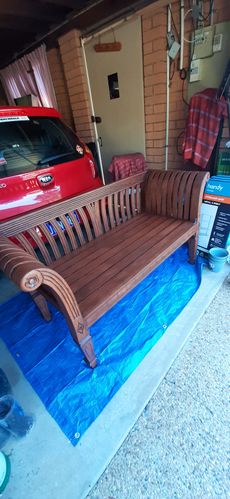

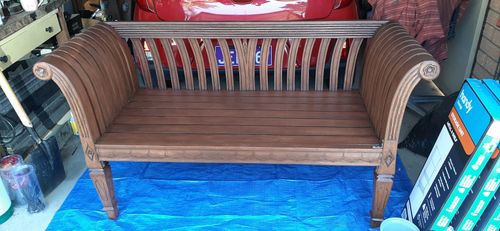

 @Former Workshop member Finally I have a few moments to het on here and update.
Your bench looks great, I love the colour!
Well, I followed your advice and got some oil paint, had already bought Monte Marte brand, so am hoping it will be fine.  I chose Phtalos Blue, which is a navy and Rose Madder, being a lovely fark but subdued red.  Have applied three coats of the tints, linseed and turps, first with a goat brush and wipe off, second I applied with steel wool and wipe off and lastly a thin goat brush layer and wipe off again.  As you will see in the photos, the oil is still drying/curing and quite patchy, so I'll allowing it to settle for a few days before I apply my (hopefully) last.  The tint looked so dark in the jar when mixed up, but of course only slightly changed the tone, I'd still like it a bit darker and thinking of using more of the blue oil paint in my last coat, but am being conservative.  You will be able to see that I had to repair the front right side of the seat where it sits/attaches to the side, it was badly damaged and no amount of glue was going to hold it, it doesn't phase me tho, I don't really notice it and thought when I get a couple of cushions on there, it won't be an issue.  I absolutely love the feel of it, I'm so glad I went down this road, I e never used linseed oil before and I'm amazed at how, even tho I had applied a stain, the character of the wood was brought out, it's beautiful, can't really see in these photos tho.  Well, like I said, I'm allowing her to sit for a few days, maybe even a little longer, I'm in no hurry, I have ended up with a gorgeous price of art that was going to be sent to the tip, and I feel very accomplished! LOL.

Hi @jgsa1967,
That looks great! Monte Marte is fine - they're an Aussie brand. I can't answer to the Rose Madder being colourfast though. It's usually one that fades quickly, unless it's the synthetic version, an even that can be iffy. Is there a colourfast rating on the tube? From memory, I think there is with that brand. I'm pretty sure phtalo blue is colourfast, but it's quite transparent - great for stains.
It's looking good! Hope it goes well
Yeah - linseed is a dream... and you never get flaking and 'paint failure' like with the modern stuff.. You just have a much more limited colour palette.
Epoxy works well for repairs, but I wouldn't do it if she's an antique.

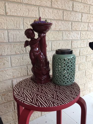

I sprayed this tatty old plaster statue just yesterday - just holds enough mix to hold a tiny Joseph's coat cactus and an equally small peanut cactus... looking very 'kitsch' now, lol.
