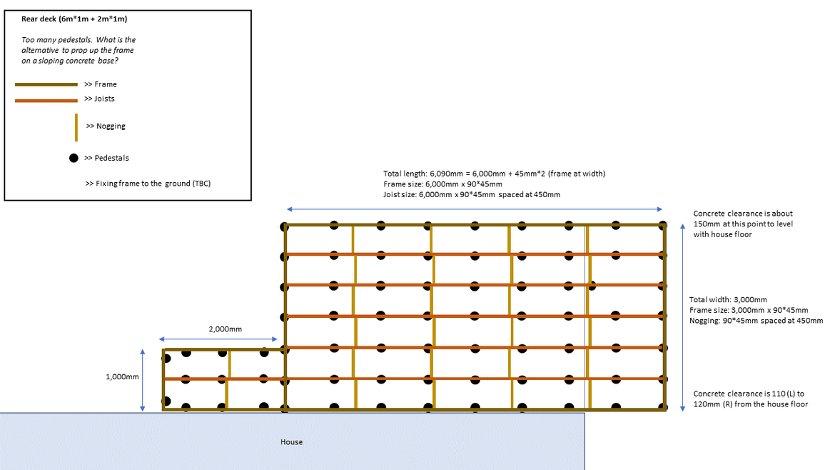

Planning on building a deck. Deck area is 3m x 6m on a concrete base that has a clearance of 110mm to 120mm from the ground at the point connecting the house. The concrete base then slopes away from the house and the clearance increases to ~150mm. I could only use 90x45 for the frame and joists due to height limitations. The deck boards would then level with house floor.
I am just at the researching phase and will take a while before I progress to the actual build (maybe when the weather is a bit kind).
I am considering using the pedestals to provide an even levelling across the deck. I believe I will need to use a lot of pedestals (about 60+) with the recommended spacing of 750mm running across the 6m joists.
The questions at this moment are:
- Is there a requirement to bolt the joists to the concrete using angle brackets when using the pedestals + nogging?
- Do the small pedestals have the ability to be bolted to the concrete?
- Any alternatives to prop up the frame? Using pedestals across the deck can be quite expensive.
I have attached an image to help visualise. One of the pedestals has gone rogue so just ignore that.
