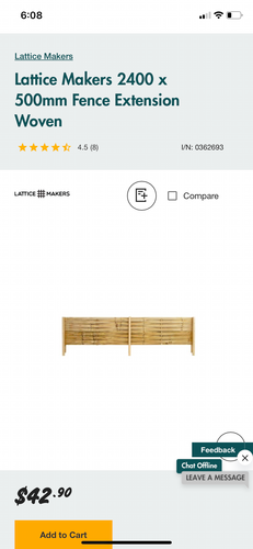

What is the best way to attach this fence extension to asbestos?

Asbestos poses no health risk unless broken OR disturbed, ideally fence upgrades would include removal/replacement of this hazardous product, that said fence extensions added to an existing asbestos fence (in good condition) would need to be self supporting (independant upright posts).
Please excuse the ad-hoc rough mock up 😉
As @DIYGnome says Asbestos is safest undisturbed broken and drilled etc, I will put a new post in against the asbestos (if it isnt removable with many precations.) And attached the lattice extentions to the new post leaving the adjacent asbestos totally undisturbed. I would paint and bind the asbestos to further protect your self if in the raw state if it isnt removable in a safe way.

Hello @tarshgardiner
It's great that you've received excellent advice from our members. I agree with the recommendations made and that is to use independent posts separate from your existing fence. The odds of shaking, moving or disturbing the fence is too great and if any of its dust particles spread around, you'll contaminate yourself and your neighbours.
I propose having a look at 75mm 3.0m Pole Splits H4 Treated Pine Round CCA as a possible post for your fence extension. The other option of course is to have the old fence torn down by an asbestos removal company and have a new one put up. From a long-term investment point of view, it is a plus for your property if there is no mention of asbestos if you ever decide to sell your place.

My apologies, I should have mentioned that it will need to be dug into the ground and concreted for installation. Since the half round is not showing up, I suggest having a look at this one instead 75 x 75mm 2.4m Post H4 Treated Pine Radiata CCA. As I mentioned in my last post, I don't advise disturbing the asbestos fence as it is toxic.
In regards to attaching the extension to the post, I suggest using Zenith 8 - 10 x 50mm Galvanised Countersunk Rib Head Timber Screws - 50 Pack.
Thanks again Eric! It seems like concreting in large posts might be a bit of overkill for this cheap fence extension so I think I'll go back to the drawing board ![]()
