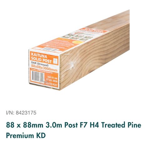

In order to install a handrail, I first need to attach timber posts to the top, middle, and bottom of my metal stringer staircase.
Am I able to just drill a hole and put a bolt through the timber post and metal stinger to join them?
