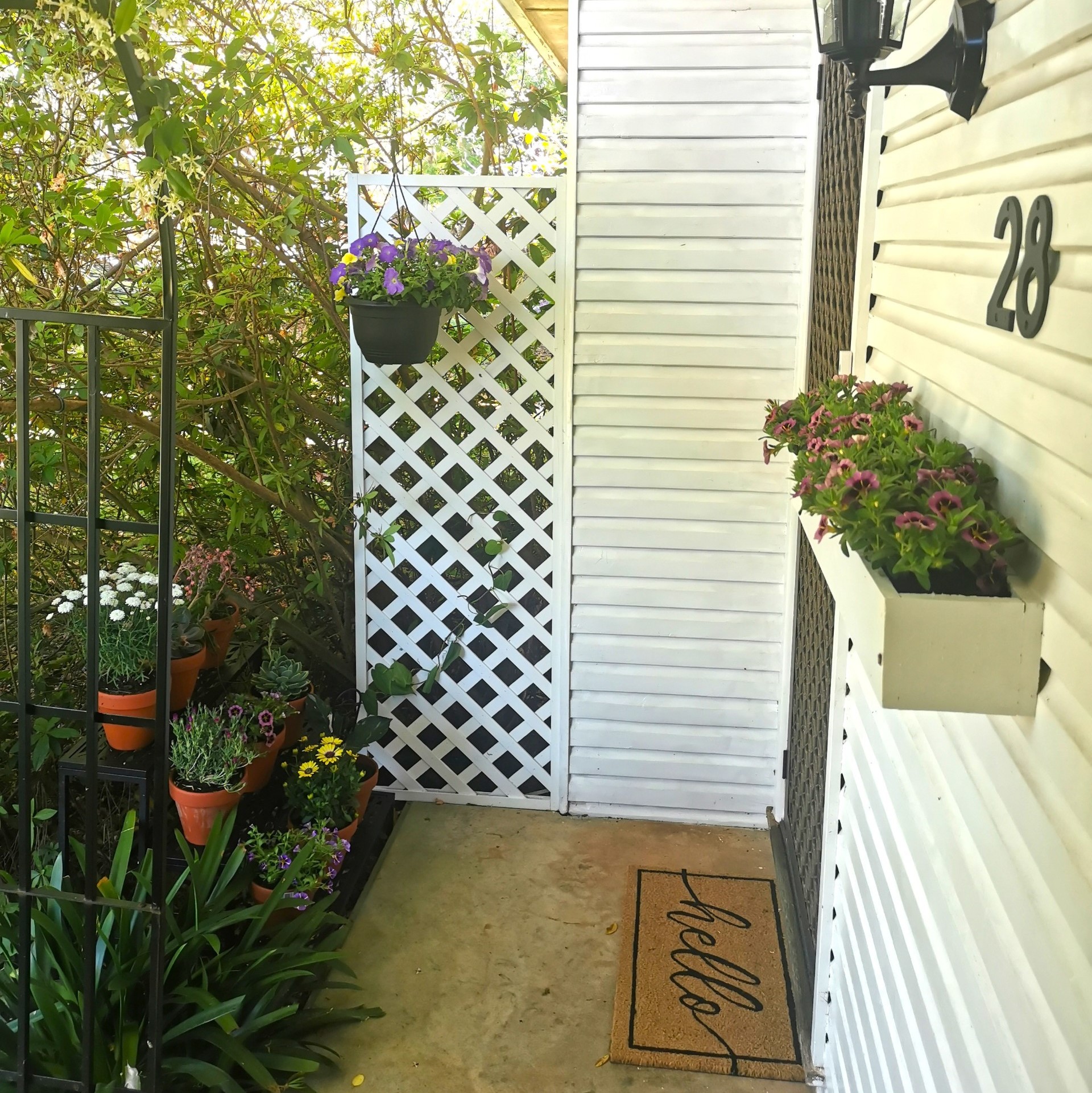

Can one tint the color in a standard Dulux spray can to be a custom color?  I want to match the color of other garden fixtures with the color of a new lattice that is very labor-intensive to paint manually.  Please advise the cost per can and the spray can coverage.  Your advice will be very appreciated.
