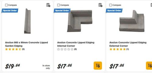

Jumping ahead I propose:
Concrete edging on both sides with lipped edging around the tap drain and a garden bed along the fence.
