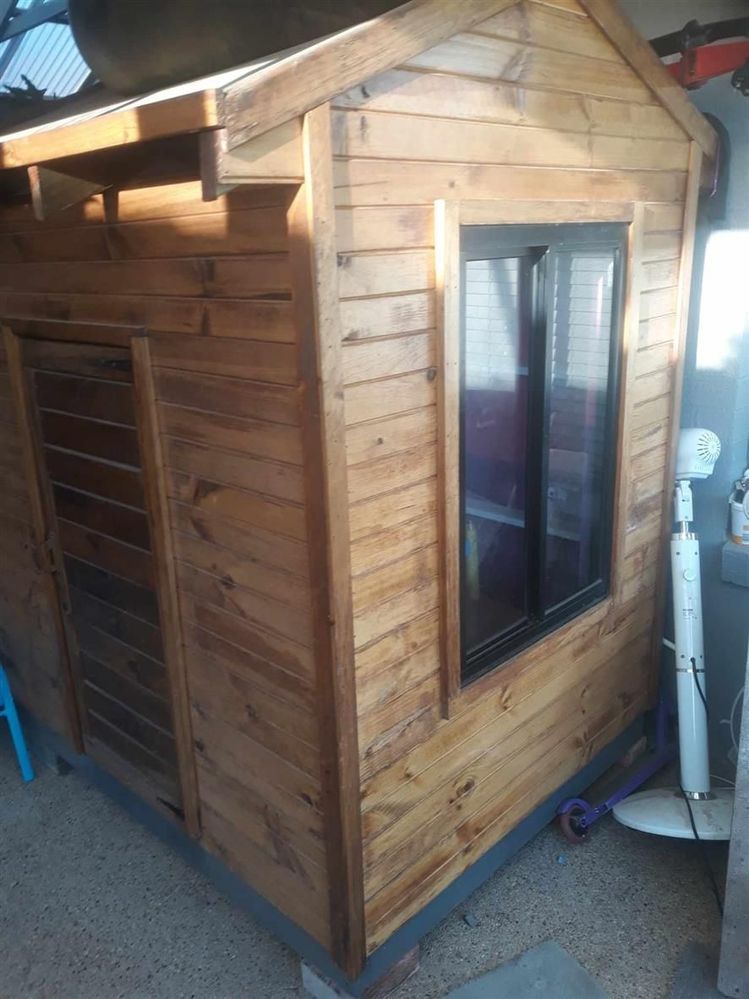

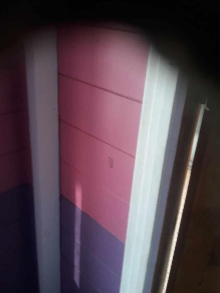

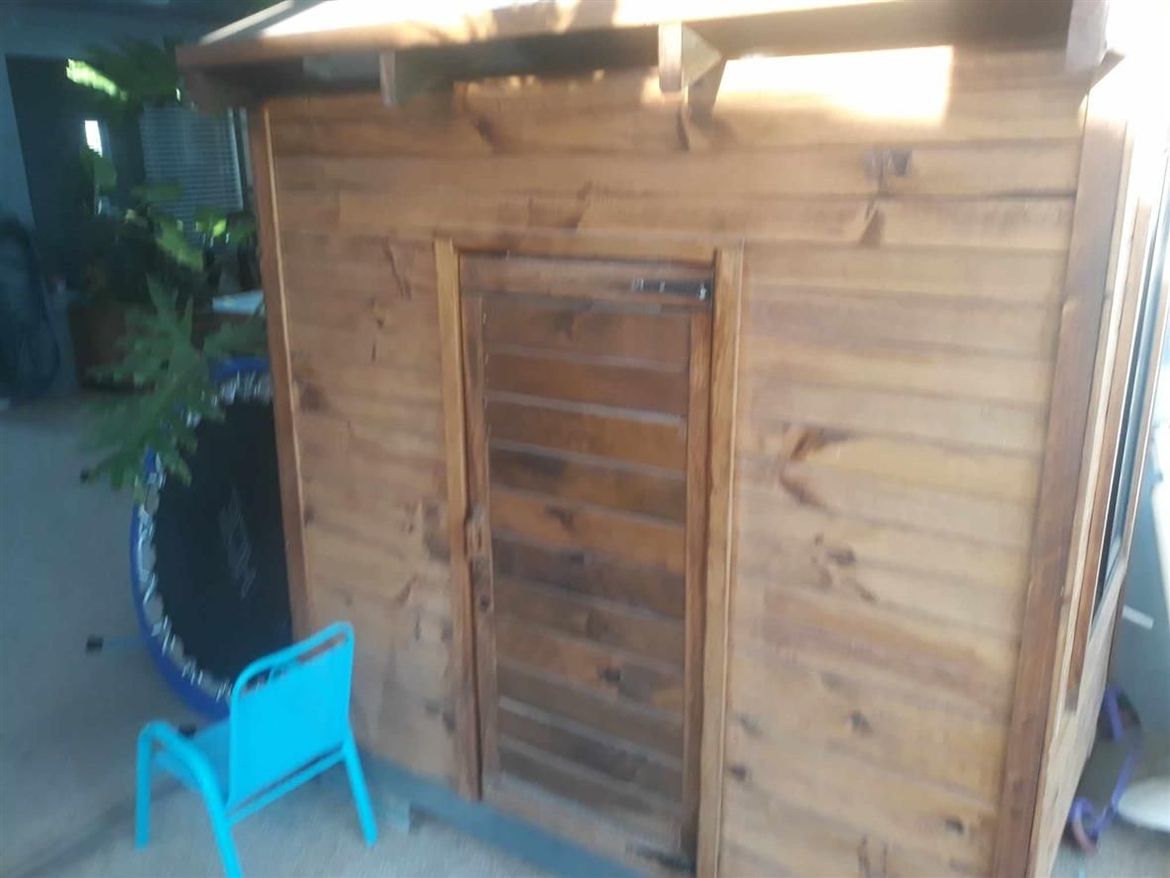

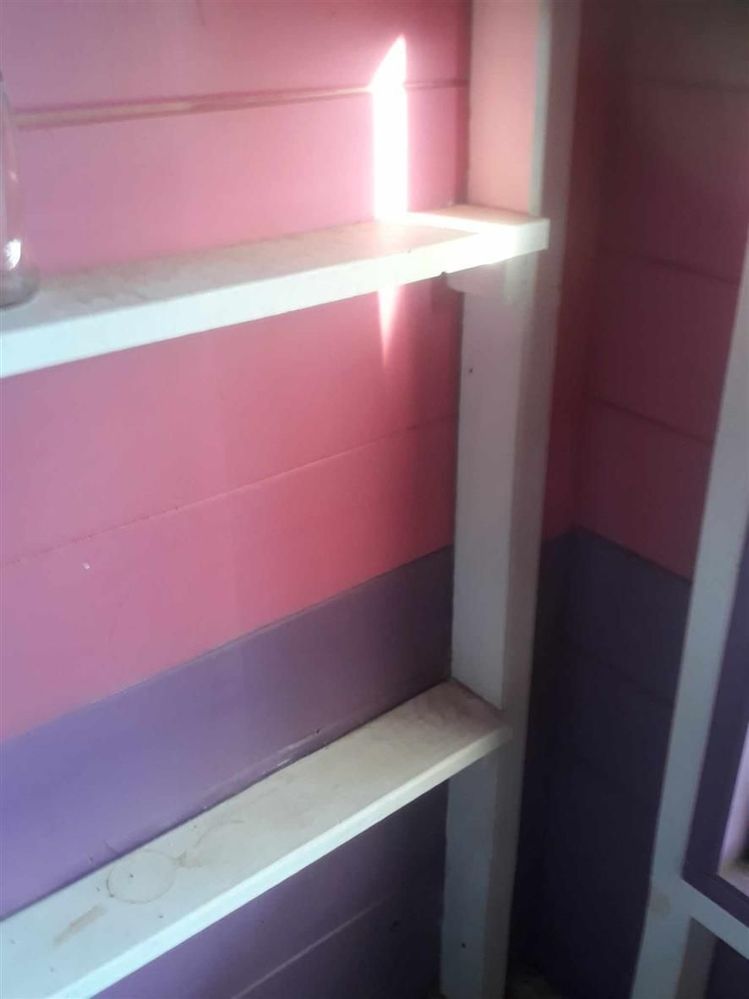

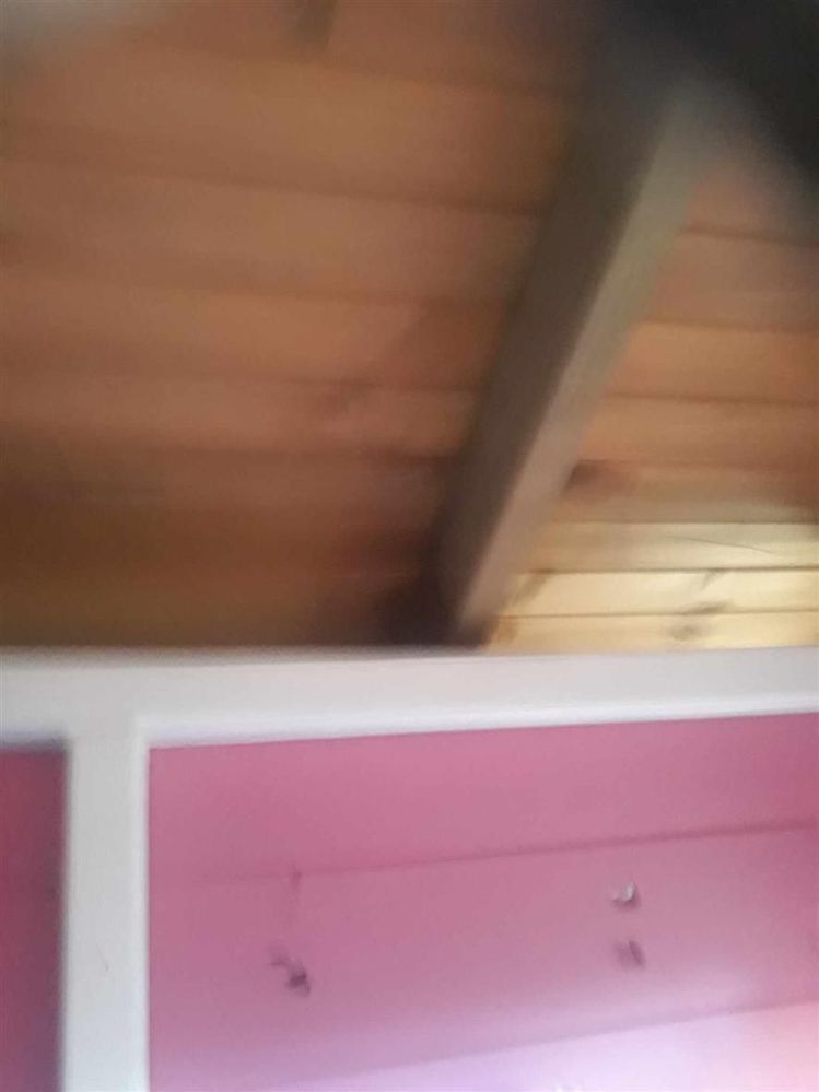

Hello Raymo,I used 70mmx45mm batterns on one I did for my grandkids a good while back,as that is what was laying around on  our site.It is also close to the size that you are considering.1160mmx1250mm.I didn't put a tin roof on it though as it's under a pergola area and weather proof,although it wouldn't be hard to screw a couple of sheets onto it if needed.I just used some pine lining boards out of the skip bin to line the walls and ceilings.I used leftover treated pine decking boards for the door and floor (didn't take a snap of it as it has some off cut carpet on it.)Regards Terry.475991216_499082213248180_8738881385356663155_n.jpg481606590_1300068617767965_9178820343363654243_n.jpg481655920_1148653939996026_8551985594921806493_n.jpg482065569_1733506477201583_5542356705948645060_n.jpg482129540_3001747429984400_3769265155497659891_n.jpg
