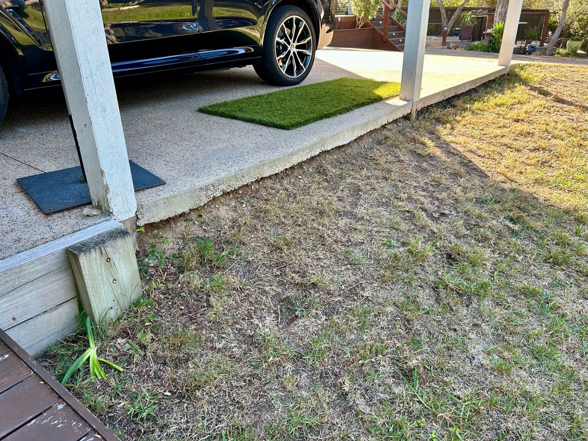

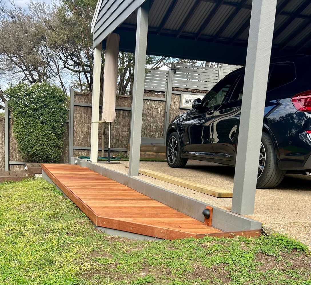

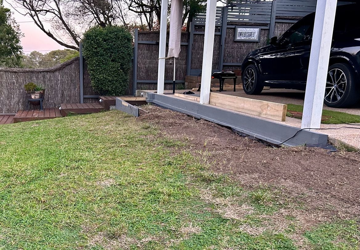

Our carport had a very ugly exposed slab after the original sleepers rotted.
The slab was unsightly with weed and grass growing out from under the slab.

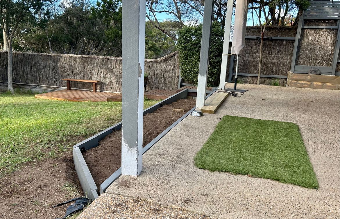

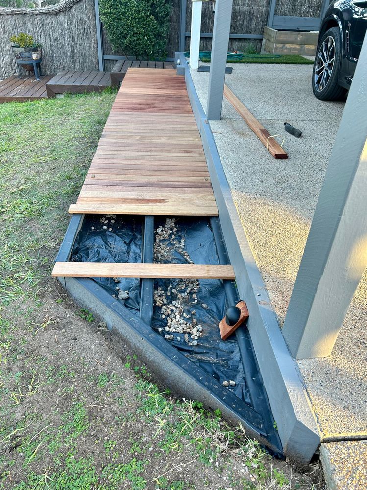

i decided to fit new sleepers having laid a black plastic barrier to avoid weeds.
After I had installed the sleepers I filled any gaps with expanding foam filler and grey sealant.
I then built a framework to support a Merbua timber deck which we use as a walkway.
The finishing touch will be the installation of three Holman mini deck lights.
Treated pine sleepers
Expanding foam filler.
Buildex Treated Pine countersink rib head 10g x 65mm screws for sleepers.
Zenith Treated Pine 8-10 x 50mm decking screws.
90 x 19 Merbua decking boards
3x Holman 045mm LED Deck Lights.
Makita 3.0Ah lithium battery drills for drilling, countersinking and fixing Merbua.
Ryobi Circular Power Saw.
Dulux weather shield Mayay Grey paint.
1/Planning and designing project

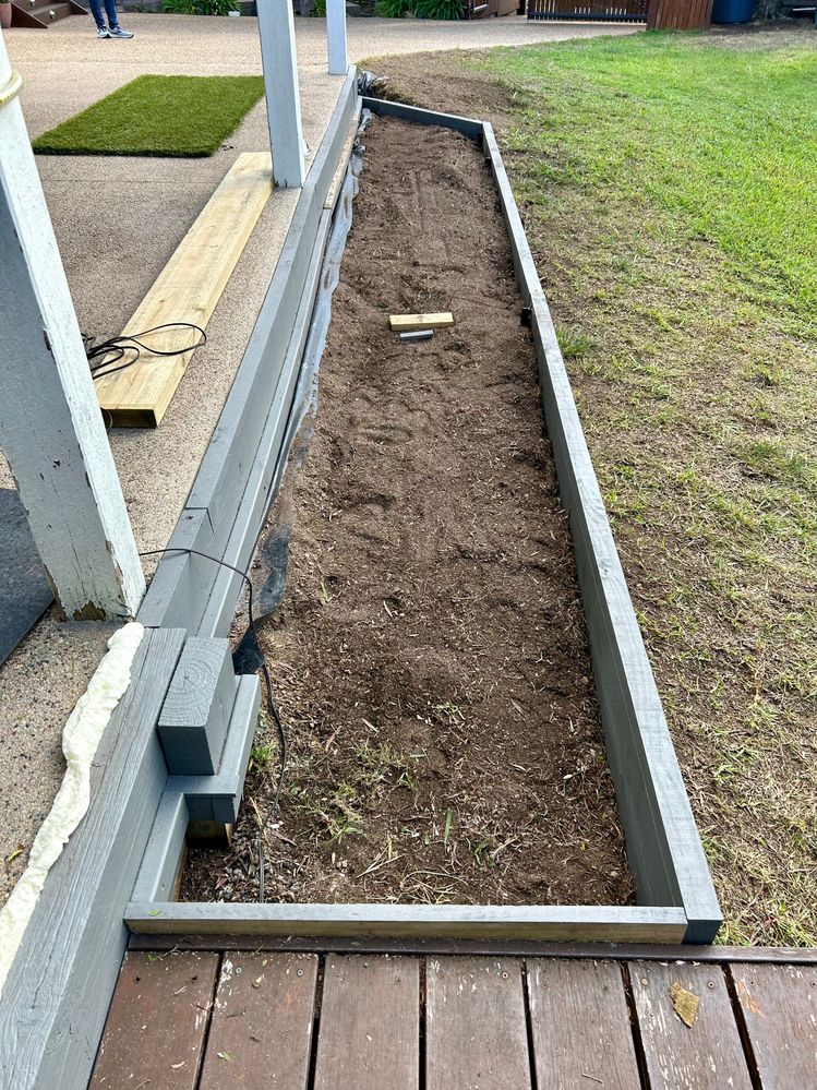

2/ Fitting black plastic along side of concrete slab to inhibit weed growth.

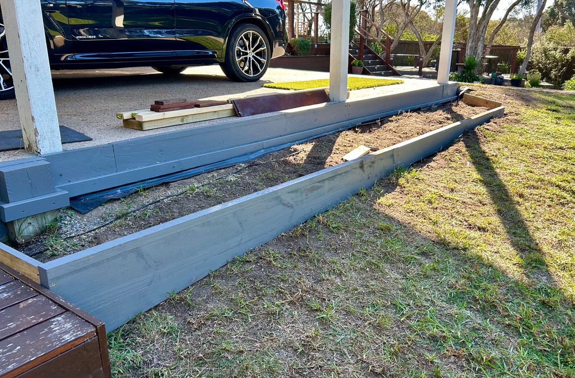

3/ Cut 200 x 50 treated pine to size with 45degree cut at one end.
4/ Installed 200 x 50 treated pine sleepers on the lower side as a frame for Merbua decking.
5/ Fitted treated pine supports along sleepers on carport edge to support Merbua decking on the higher side.

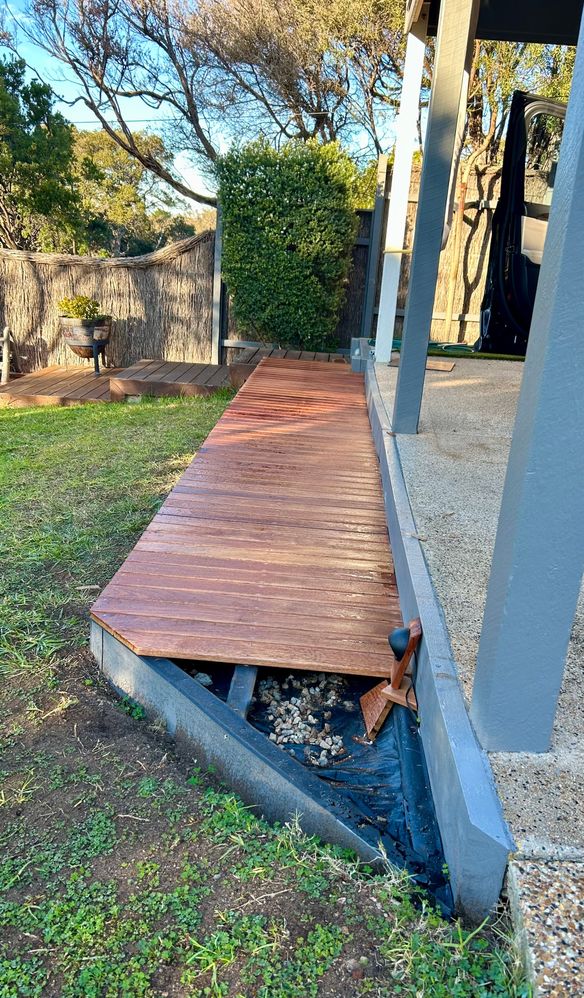

6/ Ran low voltage wire along the the underside of the Merbua decking for installation of deck lights.

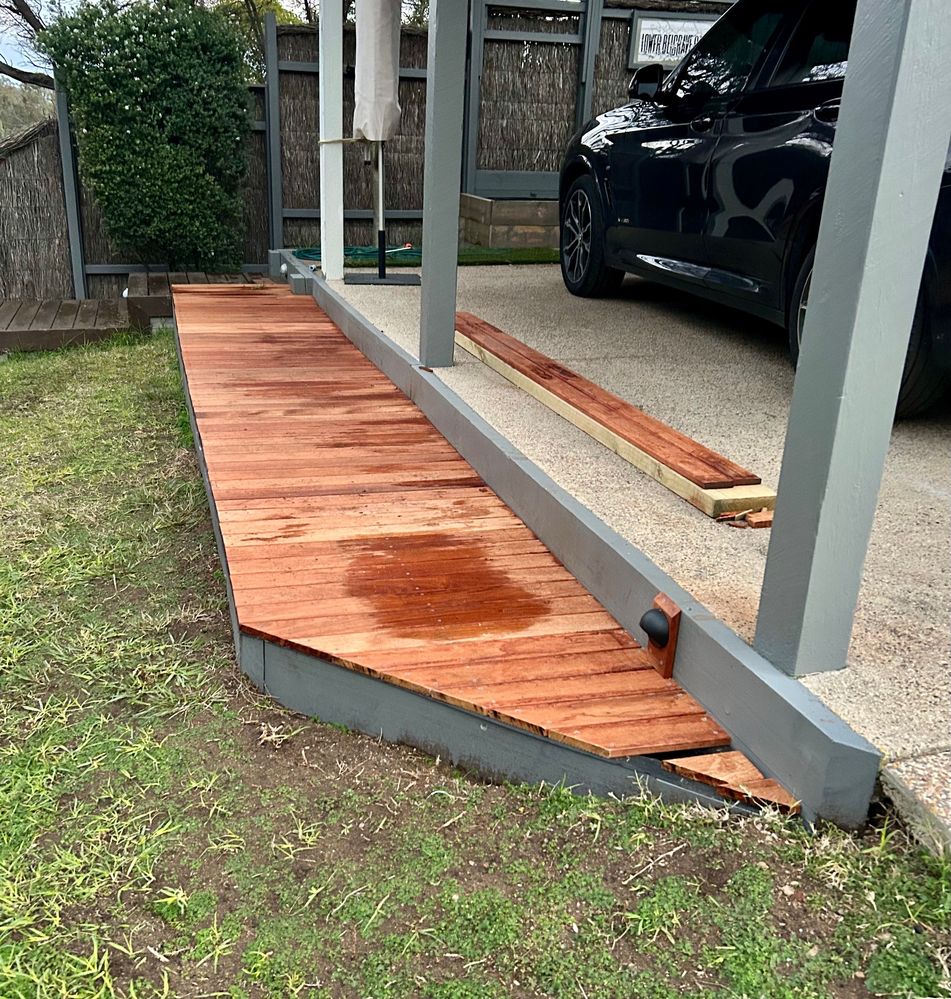

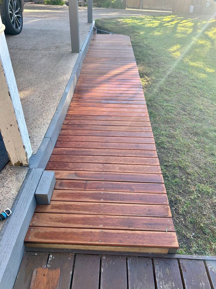

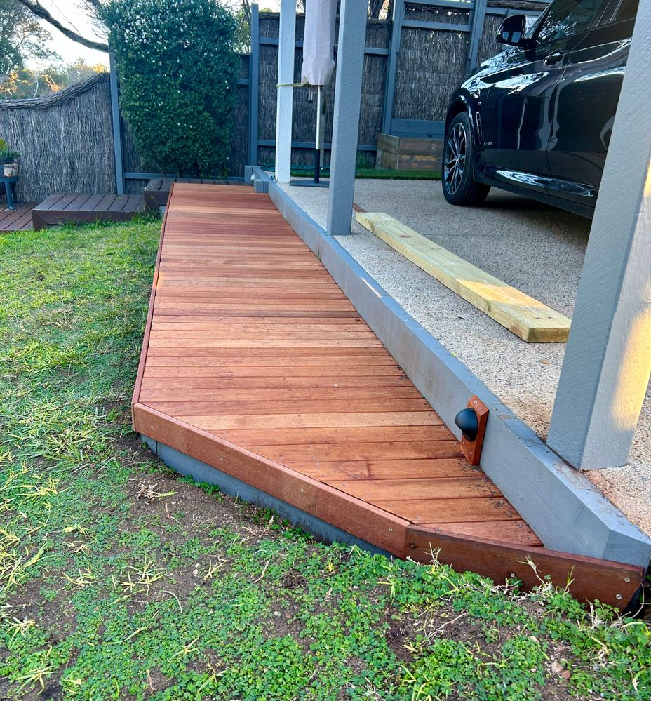

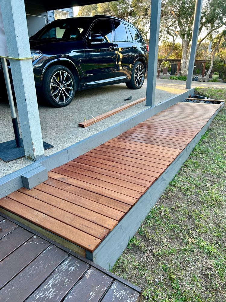

7/ Fitted 90 x 19 Merbua decking boards along the length of the framework.
8/ Cut decking boards at a 45 degree angle at one end of the decking.
9/ Fitted 90x19 decking boards along the length of the decking as a protective edge.
10/ Fitted one low voltage down light at the 45 degree end of the deck for safety and illumination.
11/ Next step is to fit HOLMAN Deck Lights ( x3 ) to provide definition along the lower edge of decking.
