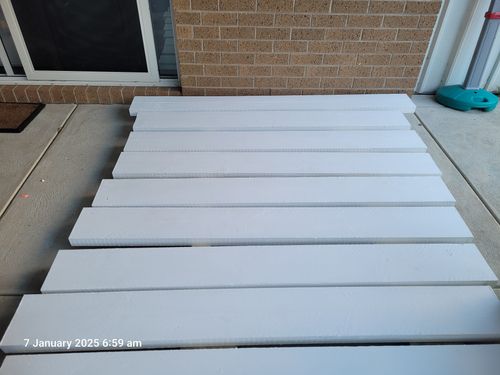

Easiest way to join these painted treated pine sleepers together to form a base for a cubby house to sit on ? Will lay 8 out them out side by side and hoping to fix them from the top.

Fixing from the top might not be all that aesthetically pleasing. From underneath, you could use a few lengths of Airco 30 x 1.0mm x 30m Structural Galvanised Strapping which would allow you to screw into each sleeper. It can then be flipped over and built upon. Additional nailing plates could be used on the ends to fix the sleepers together.
From the top, unless you're going to use some type of visible bracket, I think the best you could do is skew screw through the face of one sleeper into the edge of the next.

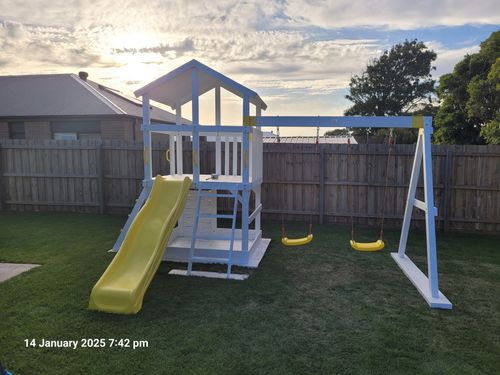

Done.  Worked well.  Thank you.
Re: Cubby House Base
Looks great @stagwad!
Many thanks for the update.
