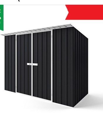

What is the best sand type to use under concrete pavers?
I am having a shed (3m x 1.5m) installed onto concrete pavers and using anchors to hold it down. Can anyone please recommend the best base to lay the pavers on, such as what type of sand please. I cannot have the shed installed onto a slab as I'm in a rental property and so I have to use concrete pavers. I have a shed company that will install it, but I'm not sure of what sand to use.
regards Jan
Re: what is the best sand type to use under concrete pavers.
Hi @bkjan,
Thank you for your question about what sand to use as a base for your concrete shed.
The specific products available can vary depending on your region, but a paver bedding sand such as this Easy Mix 20kg Paver Bedding and Screeding Sand or this Brunnings 20kg Landscape Paver Sand would be good for this application.
You'll want to excavate the area slightly so you can have a compacted layer around 50mm thick. This can be done using a tamper such as this Trojan 205mm Tamper.
You might like to have a read through How To Prepare For Paving and How To Prepare And Lay a Base For Pavers for some additional guidance.
Let me know if you have any further questions, I'm more than happy to assist.
