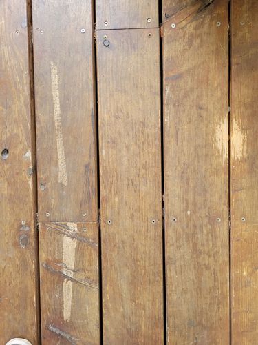

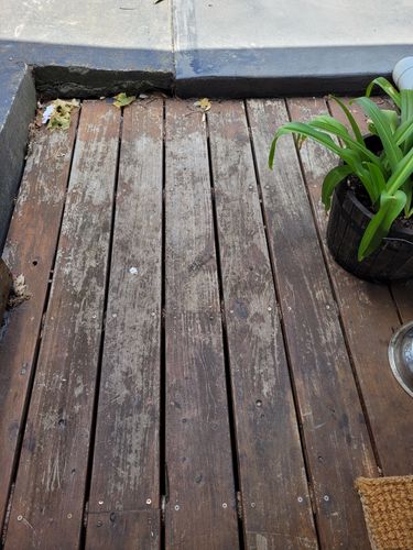

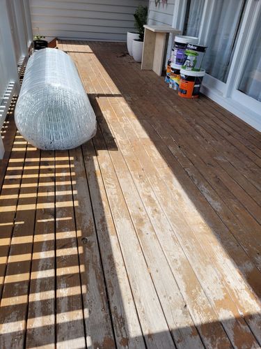

Hi there,
I'm wanting to renew my front and back decks but wondering if sanding is necessary or if I can simply clean and oil them?
The decks have deteriorated quite a bit, as seen in the attached pics.
Thanks in advance for your advice.

Thanks Katie! I had a look at Dan's article and there seem to be some great tips in there. I started cleaning my deck today in preparation for sanding (which I think I'll need to do). But the biggest hurdle so far seems to be punching down the deck nails - they're small round circular nails with a dome top and I can't seem to budge them with a nail punch and hammer... Any tips to help me get through that part would be appreciated! 😀

In reference to the decking nail. There's every possibility that you've got hardwood framing, if that's the case you'll need to hit the nail harder, a tapping motion won't be enough to move the nail.
